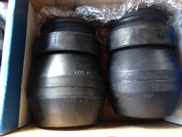

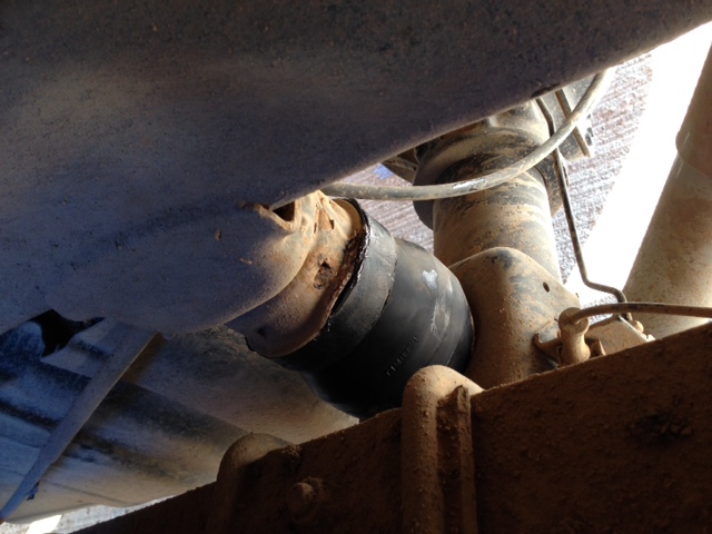

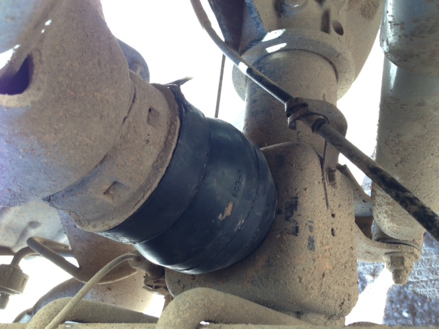

I got theTimbren 8,600lb set, really helped the sag in the rear. Kind of a harsh ride if you were used to the softness before. Takes some getting use to, you feel every crack in the road :)
The repair shop had a hell of time getting the old ones out, I'm glad I didn't try to do it myself on the ground.
I got mine for $299 with free shipping, did take a week to ship though.
Now I'm thinking about doing something with the front, with that heavy duramax in there. Thanks for the advice !
