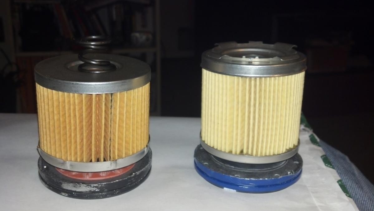

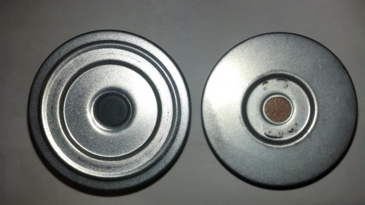

So, I thought I would get a Wix with a baseplate mount bypass valve. Turns out it is on the top of the cartridge also (similar to the ACDelco). So, it appears that all iterations of the filters for our modern LS engines have the top mounted bypass valve. This would mean to me that this is a tolerable arrangement. Upon cutting open a Wix 57060 and an ACDelco PF48 it appears that the ACDelco is actually a better filter. It had a firmer (i.e. higher psi) bypass valve and slightly more filter area. I am going to continue to use it with confidence. This of course applies to the non E-core version. Pictures Below.
Wix on left, ACDelco on right
ACDelco on left, Wix on Right
