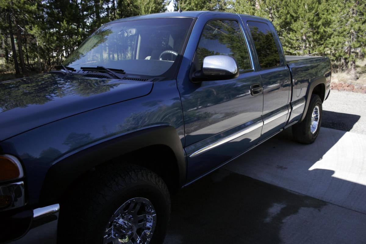

I have a 2002 Sierra 1500 SLT with the 5.3L V8. The truck has @ 98,000 miles on it and still runs great.
I'm considering swapping the 5.3L V8 for a new 6.0L V8 crate engine. (I have a 21' boat and want to get an Airstream so the extra oomph would help in towing.) I've read posts regarding the 6.0L on GM-Trucks that say that engine is essentailly interchangeable with the 5.3L and 4.8L engines, but the most recent post I could find was way back in 2009.
I'm also considering getting a new transmission to go with the 6.0L.
I have a 2011 SIerra 1500 SLT All Terrain with the 5.3L, but I REALLY like the 2002 - more. The 2002 was a dealer specced paint - one of 10 total (have never been able to find out what the actual paint color is - even after taking the truck to a couple of GM dealers and calling GM with the VIN number. After one of the dealers told me where the paint info should be I looked and found a number - dealers said they couldn't find a number - so I ordered a touch-up paint kit from one of the on-line paint resellers. Unfortunately, the touch-up paint is close but a lot darker than the actual paint.)
In any event, I want to look at the engine and transmission swap in order to "update" the 2002 Sierra.
