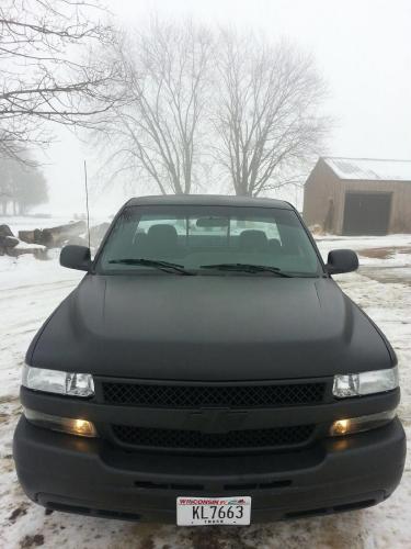

Ok I got a 99' murderado with a 5.3 swap in it... It has a retuned pcm. Can you use a programmer along with it? I was looking at a edge or something along those lines... The truck runs and drives great and has lots of power but the idea of having an on board computer to see all the trucks preformances is drawing me too the programmer?! post-138685-0-63451100-1422153511_thumb.jpg
No you can not combine the tuning, but tou can add the edge insight or scangauge 2 for monitoring
I use the scangauge 2. Mounted it in my console
