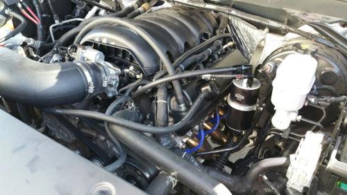

Ordered up a mishimoto catch can. During some reading while.i wait for it, I came across some.comments about also doing the passenger (clean side) . How needed is this and if it is, does it require a second catch can?
Sent from my SM-G900W8 using Tapatalk
No, the clean air separator is a separate item. It is just a set up where the vent lines to the air box are redirected for the collection of any minute amounts of oil in this clean area and redirected back into the oil system. Most use a replacement oil fill cap with a breather with a line from the breather going to the air box. The other lines are then redirected or plugged off. The amount of oil collected in this area is small.
Some companies do redirect this into a catch can, but since the oil is clean enough, I would redirect it as above.

Really late reply baha but thank you for the heads up, I'll eventually look into a kit fir the cleanside as I'm still seeing posts of people without one finding oil in Thier intake
