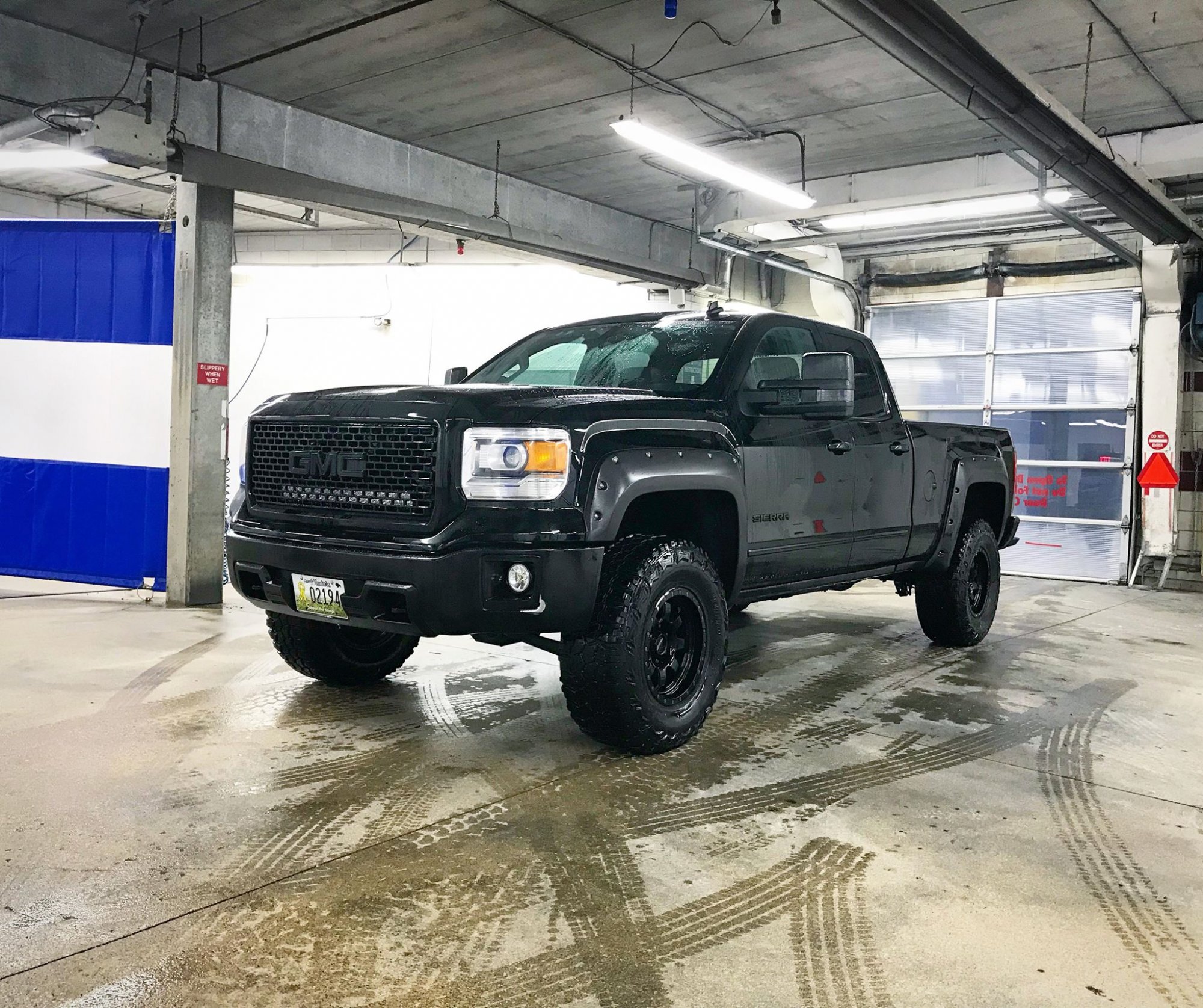

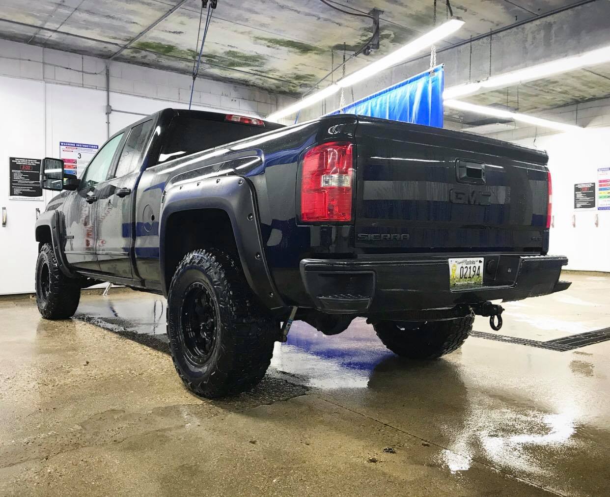

So I went ahead and bumped up to 35's (35x12.5r17). I have 3.5" lift and it only rubs VERY LITTLE at full lock. Just need to trim the inner fender carpet liner a bit. Wheels are 17x9 with 4.5" backspacing (-12 offset)
33s vs 35s

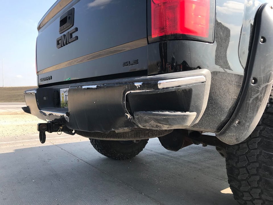

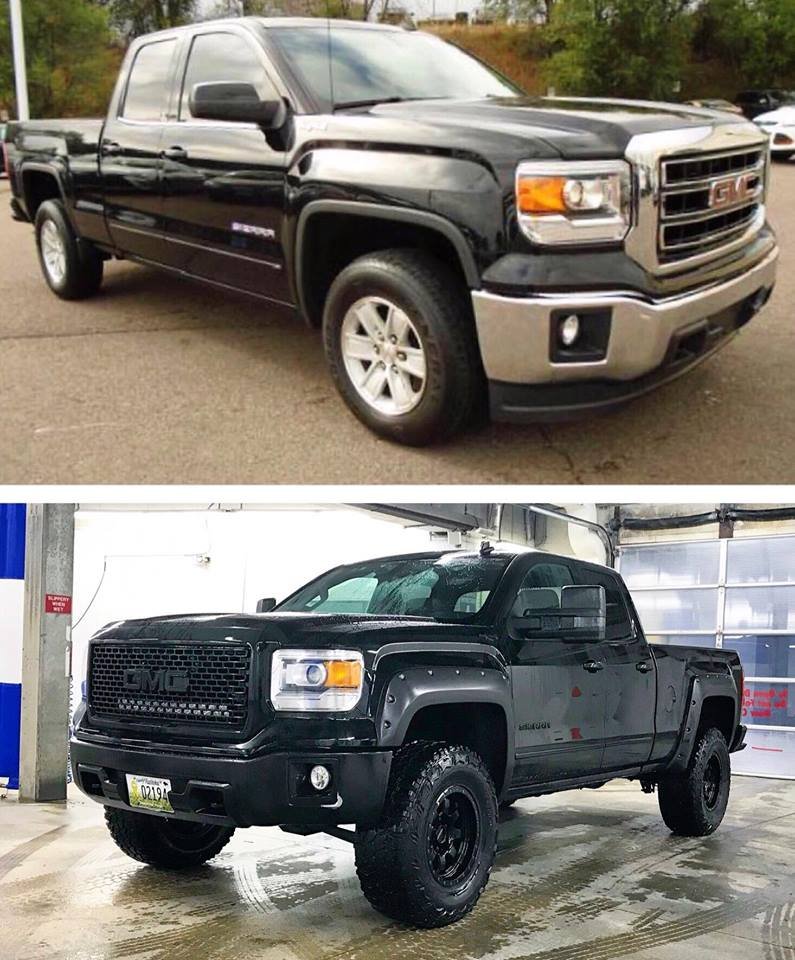

Well, it's been a long time since I have updated this, but there have been a few updates. I got rear ended by a Civic doing 60km/h while I was stopped at a red light. So I got a new colour matched rear bumper from that deal. I also installed a black Denali grill as well as smoked lens tow mirrors.

BEFORE & AFTER (Transformation)
