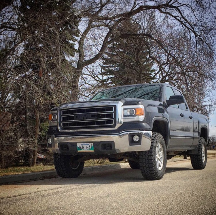

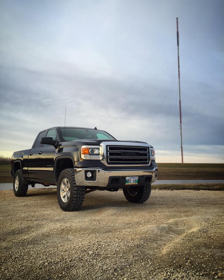

Well I got the lift done on Saturday, which took me about 6 hours to do on my own and the tires on Monday. Love the look and ride!

Did you have to cut anything to do the differential drop? how do the angles look now?
Only had to trim the cooling fins on the front diff to clear the front cross member as well as cut about a 4x3" notch out of the front cross member. Nothing crazy. Angles are fine, as I got the new UCAs.
nice ok yea i wanted to do something like that, the thought of cutting the frame got me a little bit nervous though.
