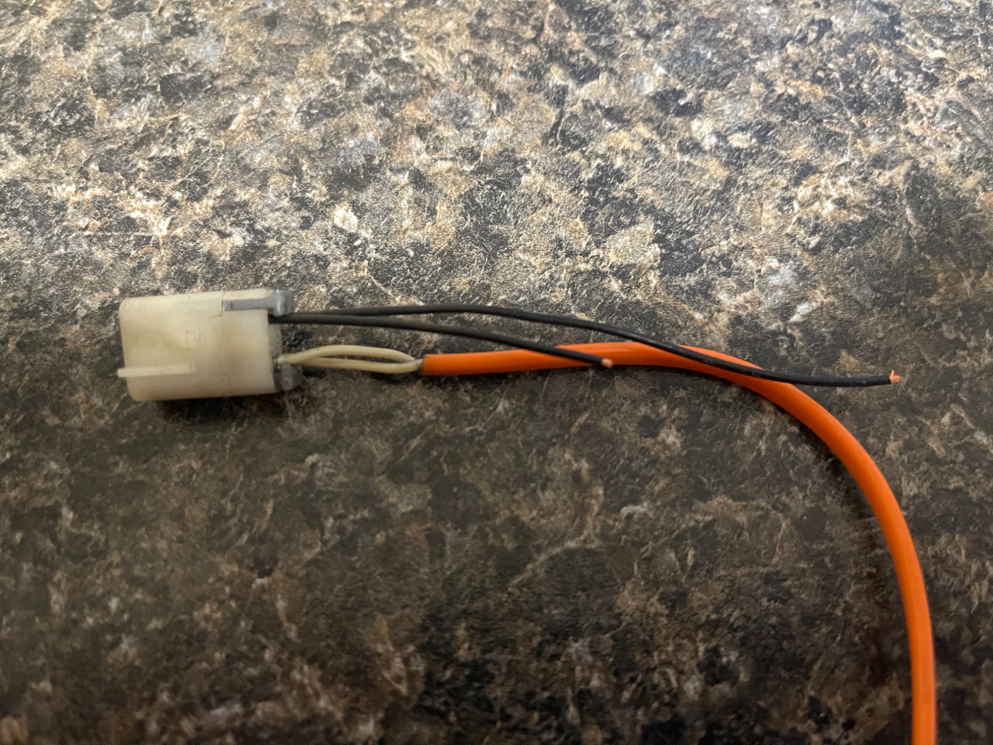

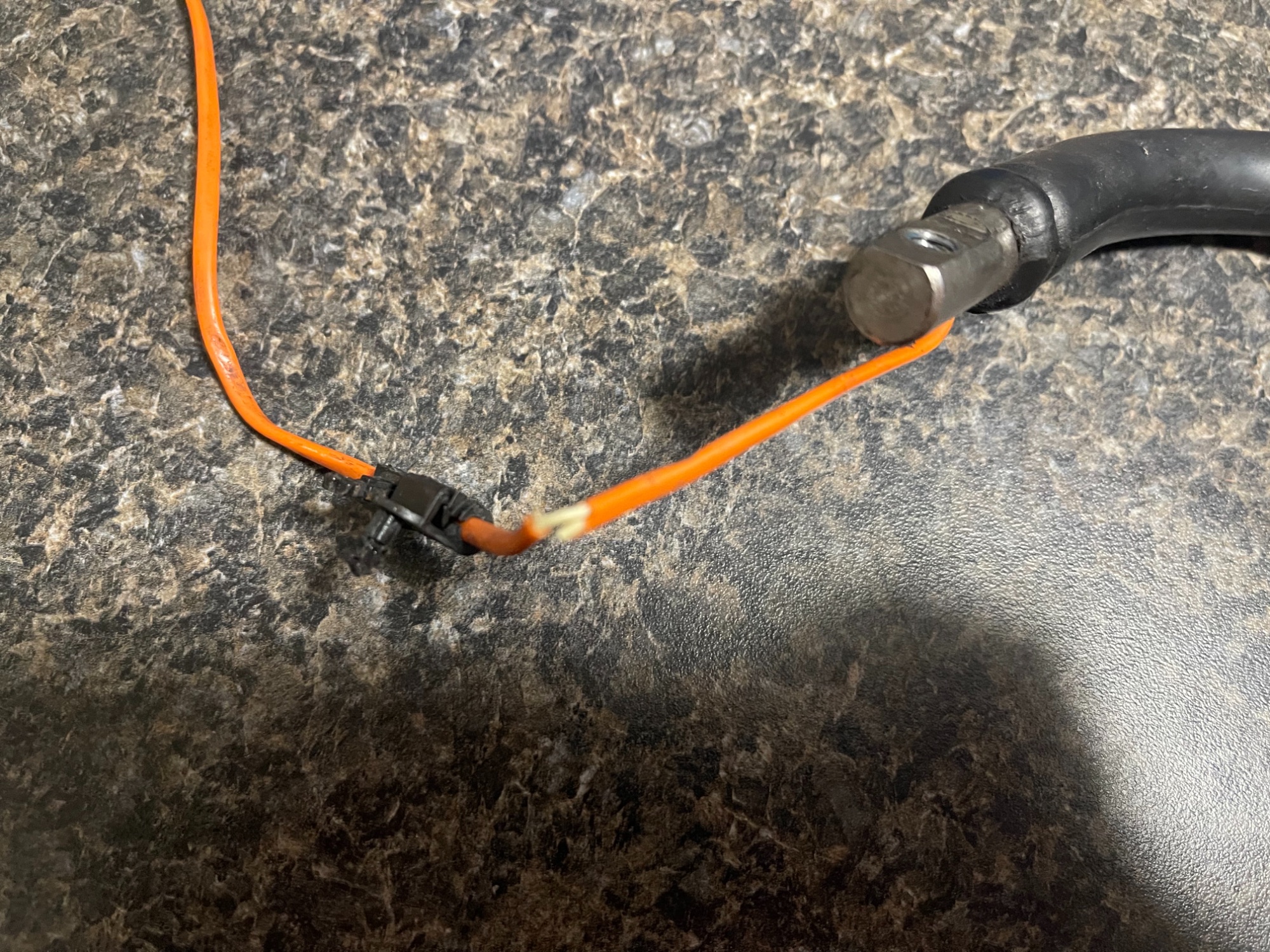

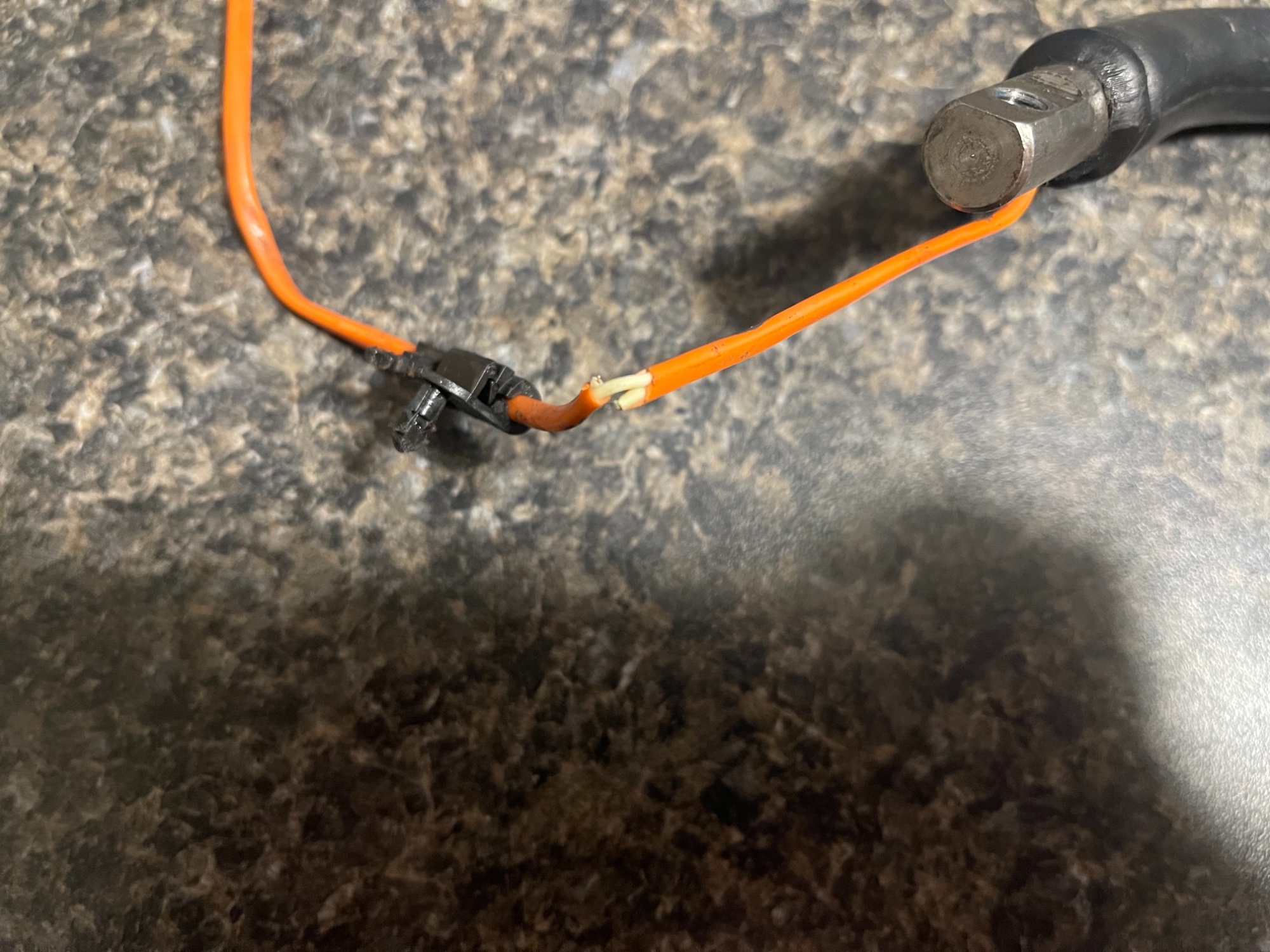

Found my issue! I was looking around under the drivers side dash and I tugged on a small bundle of taped up wires and they didn't move. As soon as I saw that I knew. When I put the nut back on under the dash where I put the ground for the mirrors I somehow managed to pinch the purple wire from the OBD2 port, so it was grounding out. As soon as I took the nut off and got the wire out everything started working again. I fixed the wire and off she went! Sucks that it was my fault, but at least it was an easy fix.
Ok so I did some more troubleshooting. All my grounds are good, batteries are new, everything under the underhood fuse panel looks fine. I pulled every fuse and none were blown. Replaced every relay with ones from my other junk 2006 truck. Unplugged various modules and none of that has worked. So I ended up doing more research on this and one way to help diagnose it is to get the U Codes (If you can communicate with the PCM) which I obviously can. So as I said above I have a U1300, U1301, U1016, U1041, & U1064. Now apparently the important ones here are: U1016 - No Communication with PCM/ECM - The one that I can NOT communicate with is the ECM U1041 - No Communication with Electronic Brake Control Module (EBCM) U1064 - No Communication with BCM Now another way to help diagnose is use a multimeter and probe the pins on Splice Pack 205 and see what the voltage is on each pin. What I've found on this is that a signal above 3.5v is considered high, and a signal belows 3.5v is considered low. With that being said, none of my pins are even putting out anything even close to 3.5v. Here is what I get: A - 0.14v B - 0.02v C - 0.00v D - 0.00v E - 0.00v F - 0.61v G - 0.39 H - Fluctuates between 0.27v - 0.29v K - Fluctuates between 0.02v - 0.03v L - 0.58 M - Fluctuates between 0.36 - 0.41v I also read that a low voltage issue usually indicates a wiring problem, open/shorted circuits. So that is where i'm currently at, still troubleshooting.
Thanks guy! I'm going to do some more troubleshooting today, I'll post up my findings.
Any kind of insight I can get would be great! So the truck is a 2006 Silverado 2500HD LBZ Duramax. Long story short the truck was working fine until I installed some Sparksmith LED Headlights & Boost Auto Tow Mirrors. Two days after the install I pulled the truck in the garage and noticed the LED strips on the drivers side headlights had quit working. When I installed the tow mirrors they haven't worked from the start. So while I have it in the garage and I notice that now the windows won't roll down, and the key fob no longer works. The truck also will not stay running now. It will start up, run for about 3 seconds, and then shut right back off. So I start looking through wiring all over the truck. Now I just had a transmission replaced as well, but everything worked fine until I added the lights and mirrors. So anyway I can't find anything wrong with the wiring. So I found out that when you have a U1300 code that the various modules can't communicate with each other because something is interfering with the signal. I saw that you can use the splice pack under the dash to help diagnose the issue. The problem there is I can't seem to find it. Any idea if they're always under the dash, or do I need to look elsewhere? When I use my scan tool it can not communicate with the BCM or the Transfer Case Module (Not sure of the technical term for the TC). It can communicate with the ECM & TCM. It's giving me a U1300, U1301, U1016, U1041, U1064, U0073. Can anyone narrow it down with the codes provided, or am I just going to have to go through the trouble shooting steps? I've attached the pages I saved from my scanner as well.

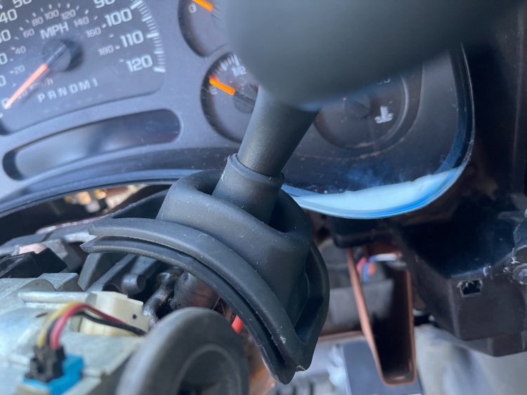

So at some point someone had installed the wrong shifter in this truck. It’s supposed to have the GMT900 style shifter with the manual gear selection button. Someone put the GMT800 style shifter in it for some odd reason. I bought the correct shifter as well as a new boot, and now everything works exactly as it should again. -

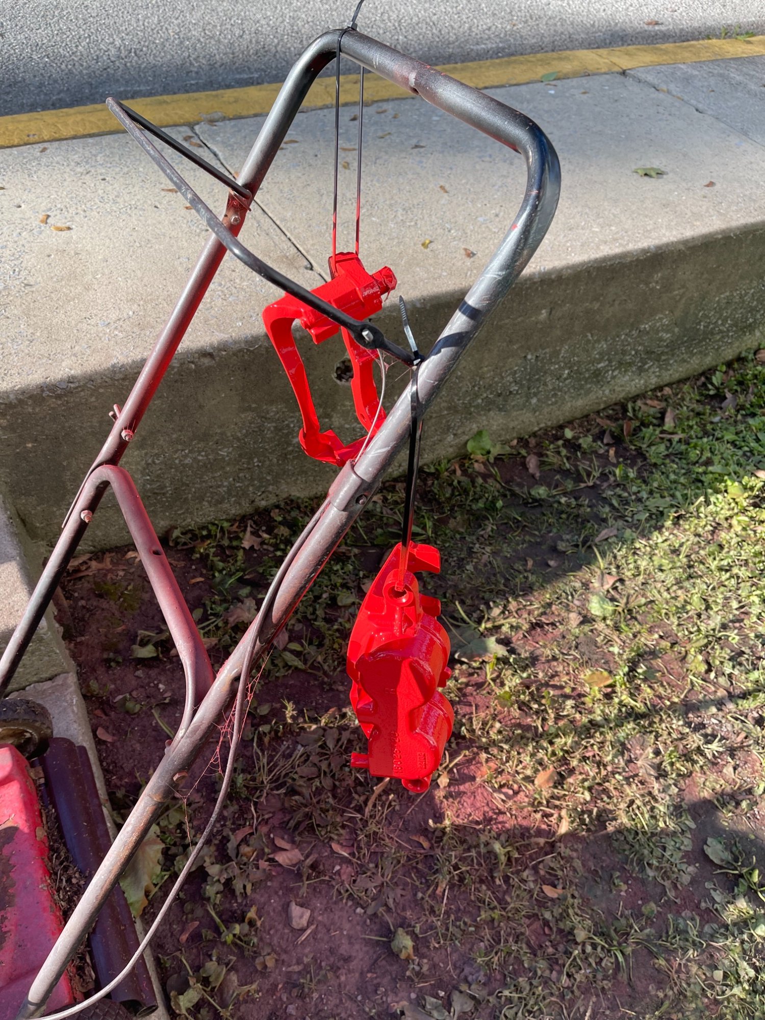

I’m going to start on rebuilding the entire front steering and suspension. I’m just going to gather all the parts I need and then tear it down and do it all at once. I bought some brand new AcDelco brake calipers a few weeks ago for the front. I painted and clear coated them yesterday. -
