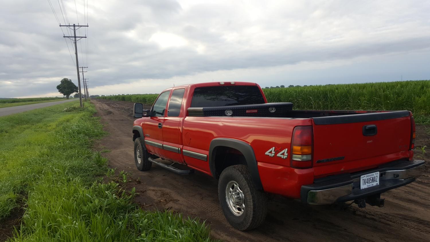

I bought my truck with 285s on it and they were pretty bald but they seemed to have held up well. I have no idea if he pulled trailers or hauled anything though. Personally I wouldn't bother with them. I put 265s on. If you look up the actual dimensions 285/75r/16 is 32.8x12. The 265s are 31.9x11 or close to that. I initially thought they looked like little tiny hot wheels tires but after running them for awhile I actually like how they look. They don't look so stuffed in there.
I'm sure you'll be hard pressed to find a tire shop that will say it's ok to put them on and everything will be fine. Yes there are some risks by exceeding manufacture recommendations. Is it a huge problem? Maybe, maybe not. Depends how you run them. I'd say either get the 265s and just deal with the inch difference, or buy wider rims. If you're lifted up or anything then maybe the nicer aftermarket rims and bigger tires is the look you're going for. If you're using it as a work truck then I'd say get some nice A/T tires with more aggressive tread and that should make it look a little nicer.
The picture with the 285s was too big to upload but that's the 265s. Toyo Open Country A/T2
