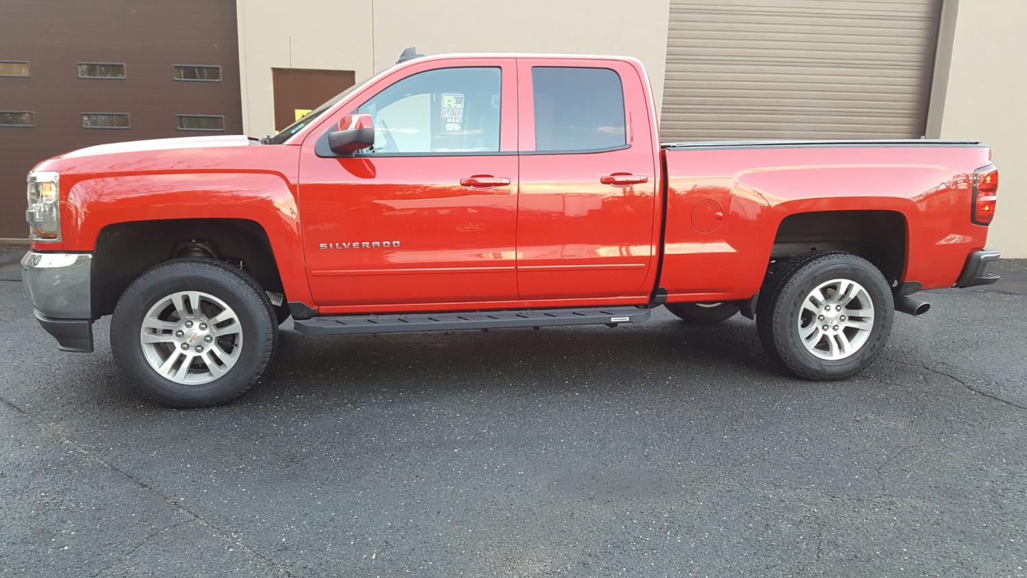

Installed the Motofab 2.5" front with the 2" rear. It was the first time I have ever pulled a suspension apart. Getting the strut assembly back together was a PITA since you need to rotate the assembly 180°.

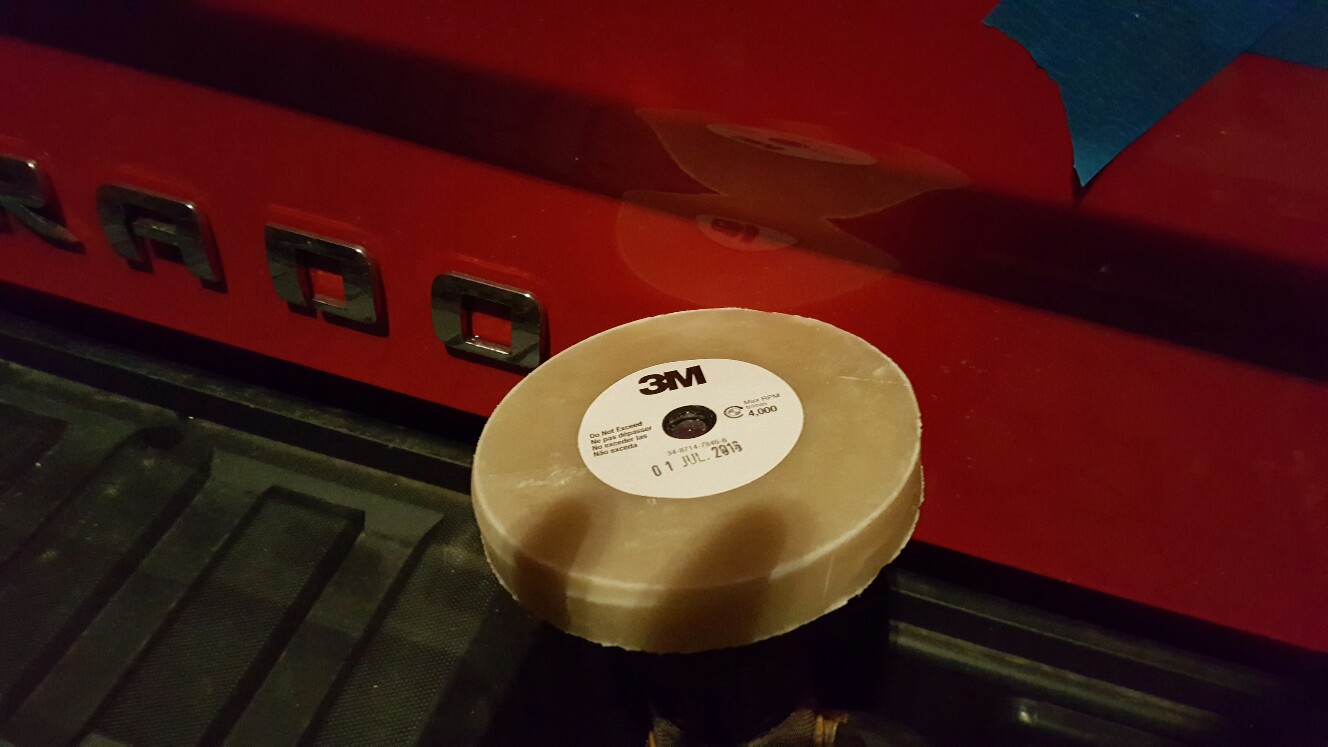

Installed the rear black bowtie. I taped off around the bowtie. Used fishing string and a heat gun to remove it. I bought a 3m wheel to remove the tape and residue left over. Then centered the black bowtie and that's it.

What sold you on the motofab leveling kit? I've been teetering back and forth between this and the RC 2"front only.
PSE truck looks awesome so far!
