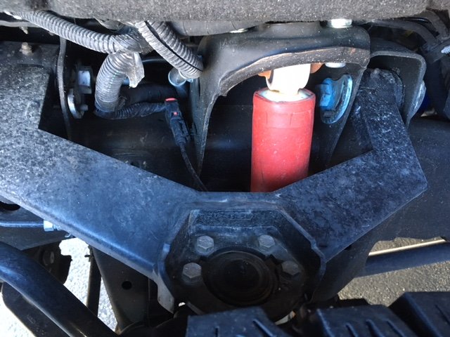

For your leveling kit, check out Central Coast Motorsports in San Luis Obispo, Ca (ccmoffroad.com). There not too far south of you. They are a small shop and build manufacture there own products, which keeps the price down. I've had their leveling kit on my '16 Denali for about a year and half...no issues. If your going to level, I'm a firm believer in buying a full kit (CCM's or any reputable manufacture) that consists of Upper Control Arms, Diff Drop Spacers, Keys, and Shock Extensions (or replacement shocks). You can just crank the stock keys and align it...but you will wear parts prematurely...like ball joints, idler and pitman arms, etc. An engineered kit keeps things closer to our factory spec. Don't over-crank the keys or your CV angles really get away from being happy. Or, you can purchase the full lift kit...these will keep angles much closer to the factory spec...

Here is a pic of CCMs UCA if you want to compare to other reputable manufactures...

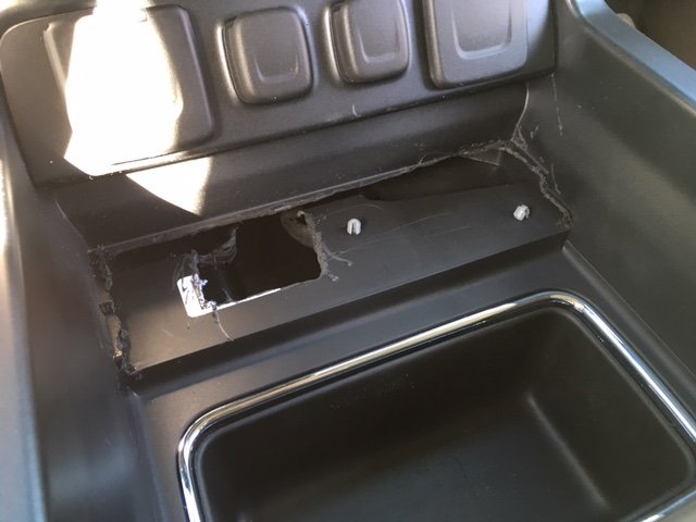

The Edge is a CTS2...monitor only.... Similar to you, my last truck was a '04 LLY. I had gauges on the A Pillar. I too had to learn the new technology with these new trucks. This is plug-n-play and plugs into the OBD2 port under the dash. I also purchased a center console mount from ProFormance Diesel in Bakersfield (pro-formancediesel.com). Plugged into the OBD2 port is not as accurate for EGT, but it does give me a close number for trending. It is expandable where you can add different sensors for more accurate results, but I chose not to go that far. Not really needed for me as I'm not deleting either...or doing any engine / tranny mods...
Here is a pic of my CTS2 in the Pro-Formance center console mount. You have to remove the stock rubber "card holder" and cut a hole for the CTS2 cable. From there, it easily snakes through the extended floor console and over to the OBD2 port. If you need to return it to stock, simply remove the center console mount and replace your stock rubber card holder. There are company's that do make CTS2 mounts for the A Pillar if you choose...
