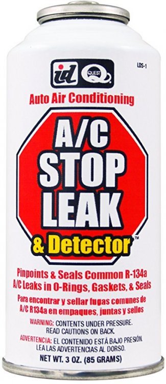

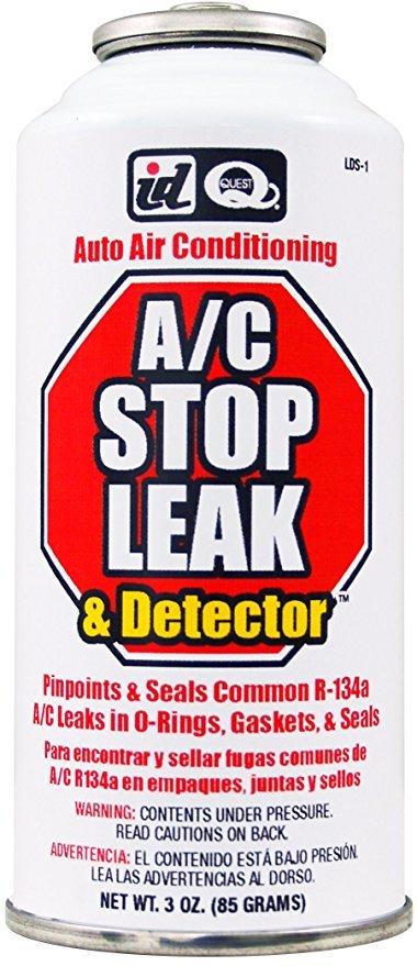

I bought the cold AC brand that also has the leak stopper in it as well.
4ba36271-fcfc-4d34-b03d-affe302ea99f_1.e
That A/C pro stuff is pretty expensive. I usually get the generic 12 ounce cans for a dollar or two each and I buy about 50 at a time, just to stock up.
Freon is Freon. Brand doesn't matter.
As for the stop leak, I have had better results with a product that is specifically designed to "stop leaks", rather than products that just contains some stop leak additives.
