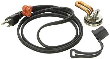

This would be an alternative to rebuilding your entire engine:
I tried it, and it worked perfectly to make the noise go away.
It cost $32.
