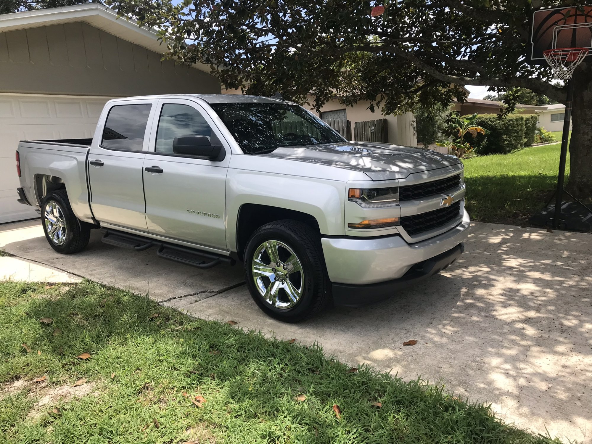

I have attached picture of the last one (black) and new one (silver)
Chris
Yes that is max you can hope for without problems you may get 32.5 if you have the aluminum UCA  ,
Its weird, the black with chrome running boards and the silver new truck with black step bars switch those and the black '15 was a keeper
That’s what I figured thanks for the reply.
Yeah Black truck had almost 100k miles had to go. I picked the new one cause it had the bars and no chrome.  I do miss the leather interior but I’ll deal some nice I don’t have all that chrome
