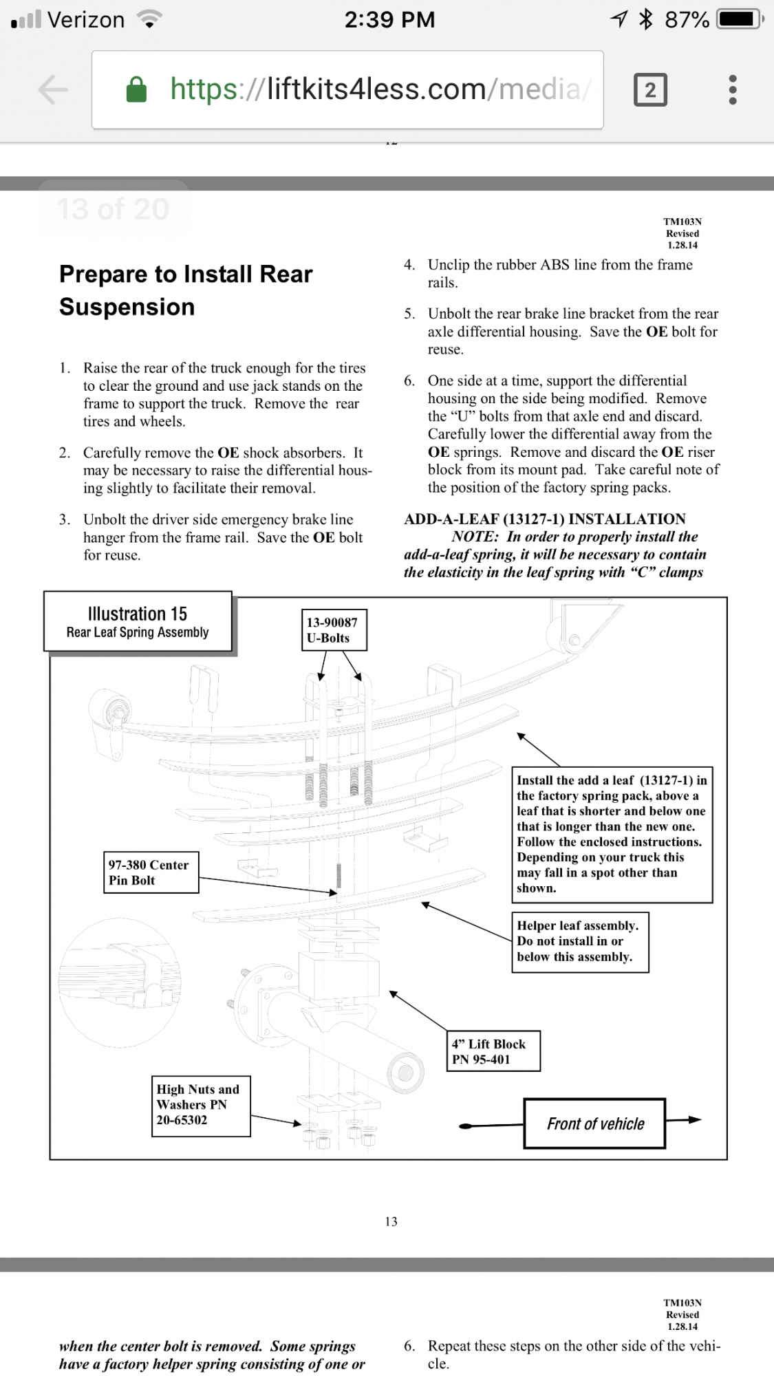

Just picked up a 2018 Silverado that already has a 6” trailmaster lift. Not thrilled with the lift but it’ll do for now. The truck sit a tad higher in the rear than I would like. The lift comes with a block and add a leaf. I think removing the leaf will drop it too far but there are spacers between the springs and the block that total 3/4” that look like they are pointless.  Can anyone think of a reason not to take them out?  03EA0CA5-94A8-4481-8384-CF4DF6960724.thumb.png.cea746d737dfca389d7f5426efa9c1e3.png
