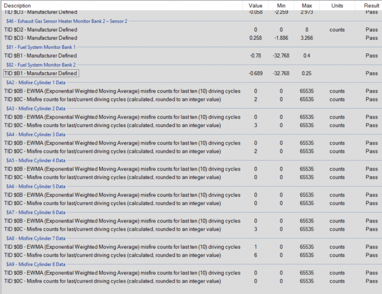

Mine used to be so smooth that you couldn't feel it when it was idling and then at about 3700 that all changed. Now I feel like it's misfiring at idle. No issues under load or acceleration, only when idling. No check engine light or any pending codes but every time I retrieve the on-board monitoring data (Mode 6), there are multiple cylinders that are showing misfire counts. I'm curious if you or anyone else that might have a similar issue has retrieved the $06 data.image.thumb.png.2837cf0d5487670e8b4e3661e9b67488.png

How did you get this?
