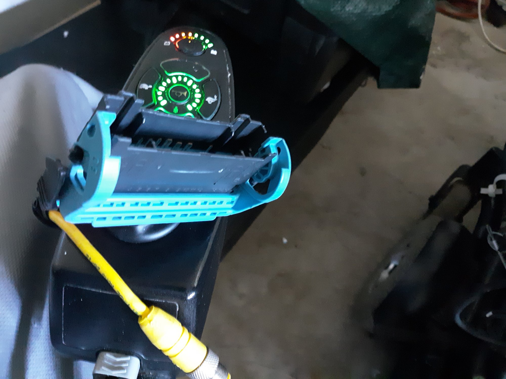

. Hello all, I have a 2013 Silverado 1500 LTZ Z71 2-wheel drive that is fully wheelchair modified so I can drive it. The driver's seat is removable and I can back my wheelchair on new a platform and it locks in place to make it to where I can drive. The factory driver seat is mounted to a metal platform with casters where it can be rolled in and locked in place if an able-bodied person needs to drive it. Complete with wiring harness to make all the power adjust functions work. However more often than not I'm the only one that drives it so the driver seat just sits wrapped in a tarp in my garage. The problem that I have is that if the driver seat isn't in the truck the factory heated and cooled seat on the passenger side doesn't work because the driver side harness isn't plugged in. Do any of you have and idea of how I can make the passenger side work while driving from my wheelchair? That's the harness that comes out of the back of the driver seat and plugs into the truck. All of the other passenger side functions work the adjust the Tilt so on and so forth just not the heated and cooled. Any advice would be appreciated
Send a PM to member : Pgamboa, he is the go to guy for wiring and harness modifications.
