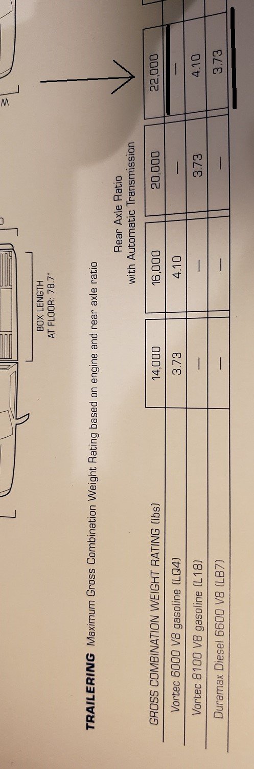

5th wheel trailer GVWR I can pull?
  22K  GCWR . ( Combination)  The 3.73 rear gear was std with that engine . see pic below.  I cannot get the pic to have the correct landscape orientation.
