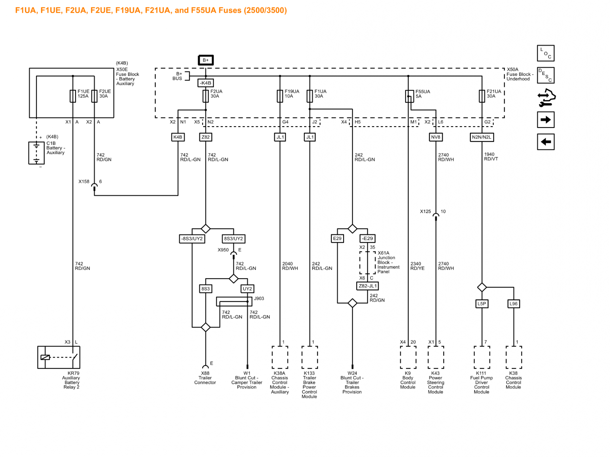

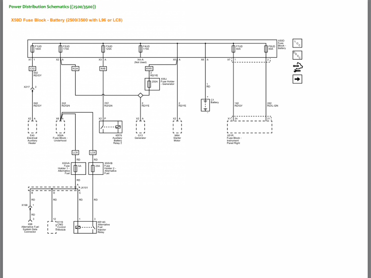

2017 Sierra 3500.  Does anyone know where the trailer hot wire is connected to battery power under the hood?  Its presently hot all the time.  I want to hook up an ignition controlled constant duty solenoid so the trailer wire is only hot when the ignition is on.  Was straight forward on my 2003 Duramax.  Not so on this beauty.  Trying to keep the truck battery isolated from my camper when the truck is off.  Thanks.
