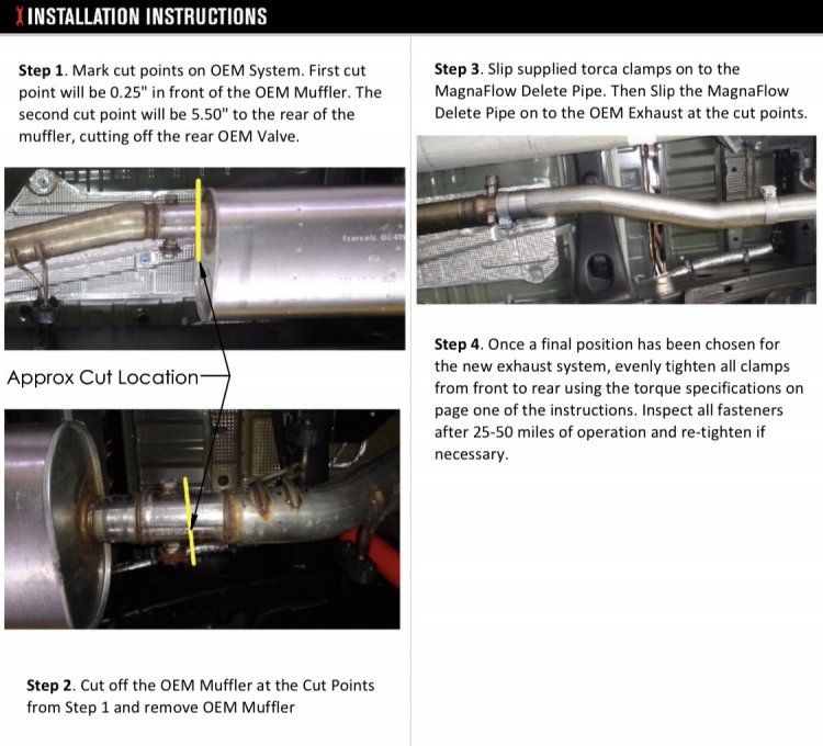

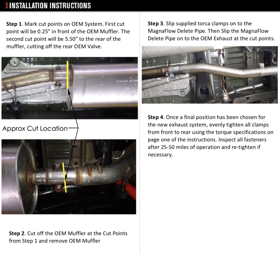

I’ve searched this forum and couldn’t find anyone who’s tried this muffler delete kit on a 6.2 w/ DFM. There’s lots of talk about flappers and removing one, both or none to address the sounds made by DFM. Has anyone just followed the instructions below, and if so what was the result? Any good?
