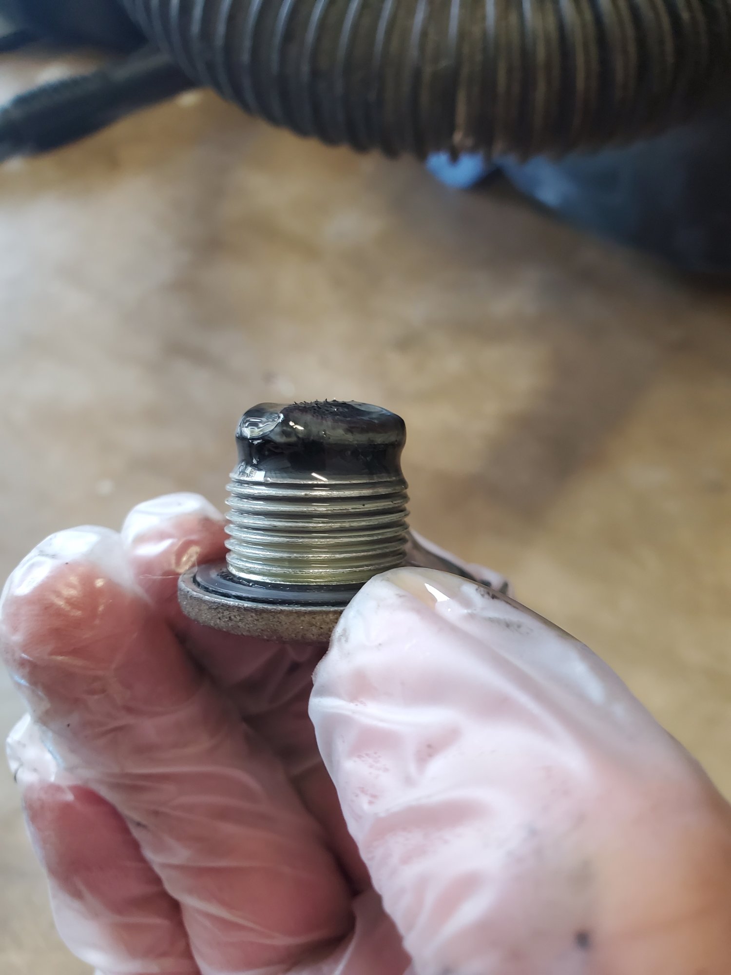

Just curious as to why the front differential fluid comes out sort of milky...or at least the existenceof some white material....anybody who has changed theirs experience this?
I'm not a mechanic....just a weekend DIYer.....so please don't roast me.  Plug had some normal sludge.

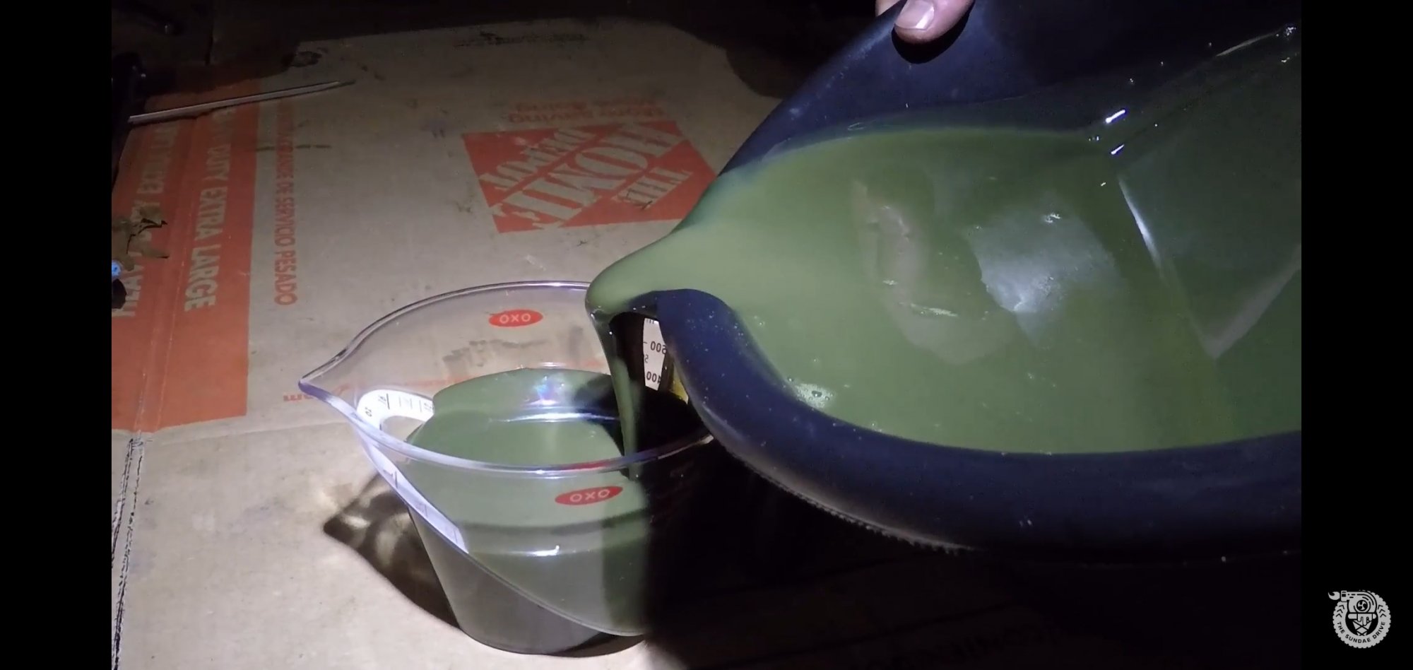

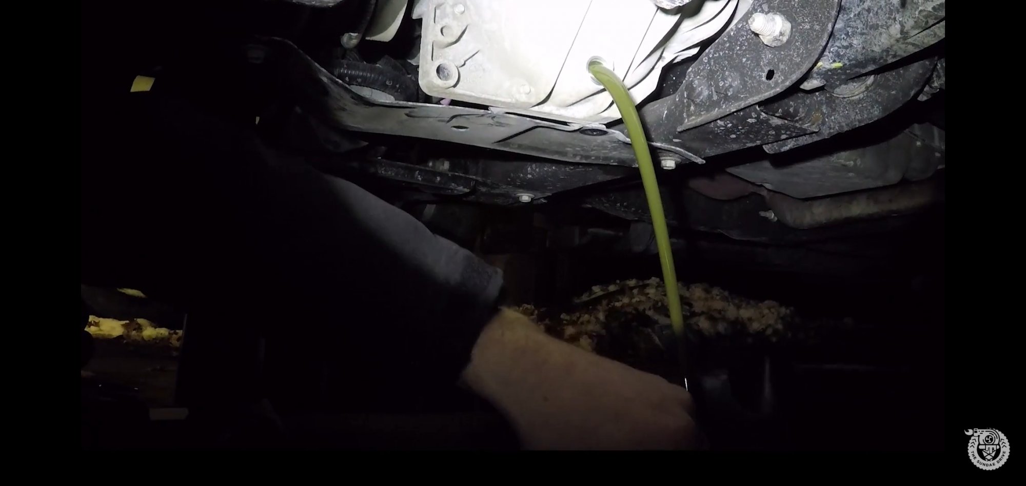

Well I definitely wasn't under 5000 miles but it definitely looked like yellowish greenish tint
Something like this
