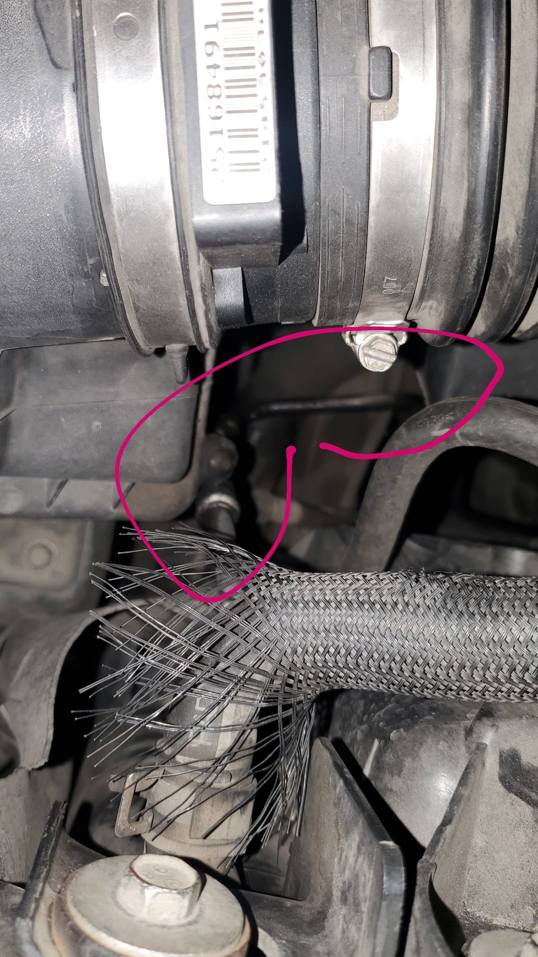

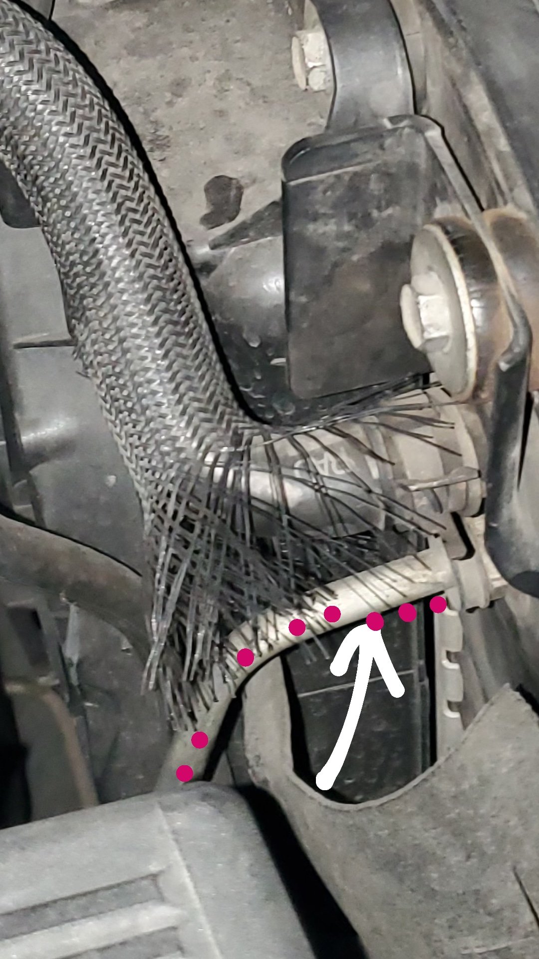

Hey guys, I have this 2006 Silverado and I can not find the name of the hose form where this leak is coming from. I am pretty sure it is leaking coolant but I can not find an actual name for this hose. Can anybody help me out?
The hose is on left side of the radiator (the front of truck facing you) and under the top most hose. It is a thin line with an odd fitting in between that is leaking
the metal line is the trans cooler line. Transmission fluid flows through it. Rockauto will list them as oil cooler lines, under the transmission category
