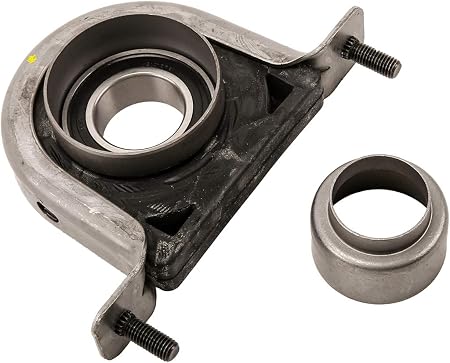

1. My driveshaft bearing carrier has no steel support plate between the bearing and mounting spot. Should this truck have that ~1/2" steel spacer? I only ask because some bearings are sold with that spacer that is currently not on my truck.

88934865 is the OE center support.
Amazon.com: Genuine GM Parts 88934865 Drive Shaft Center Support Bearing:  Automotive
