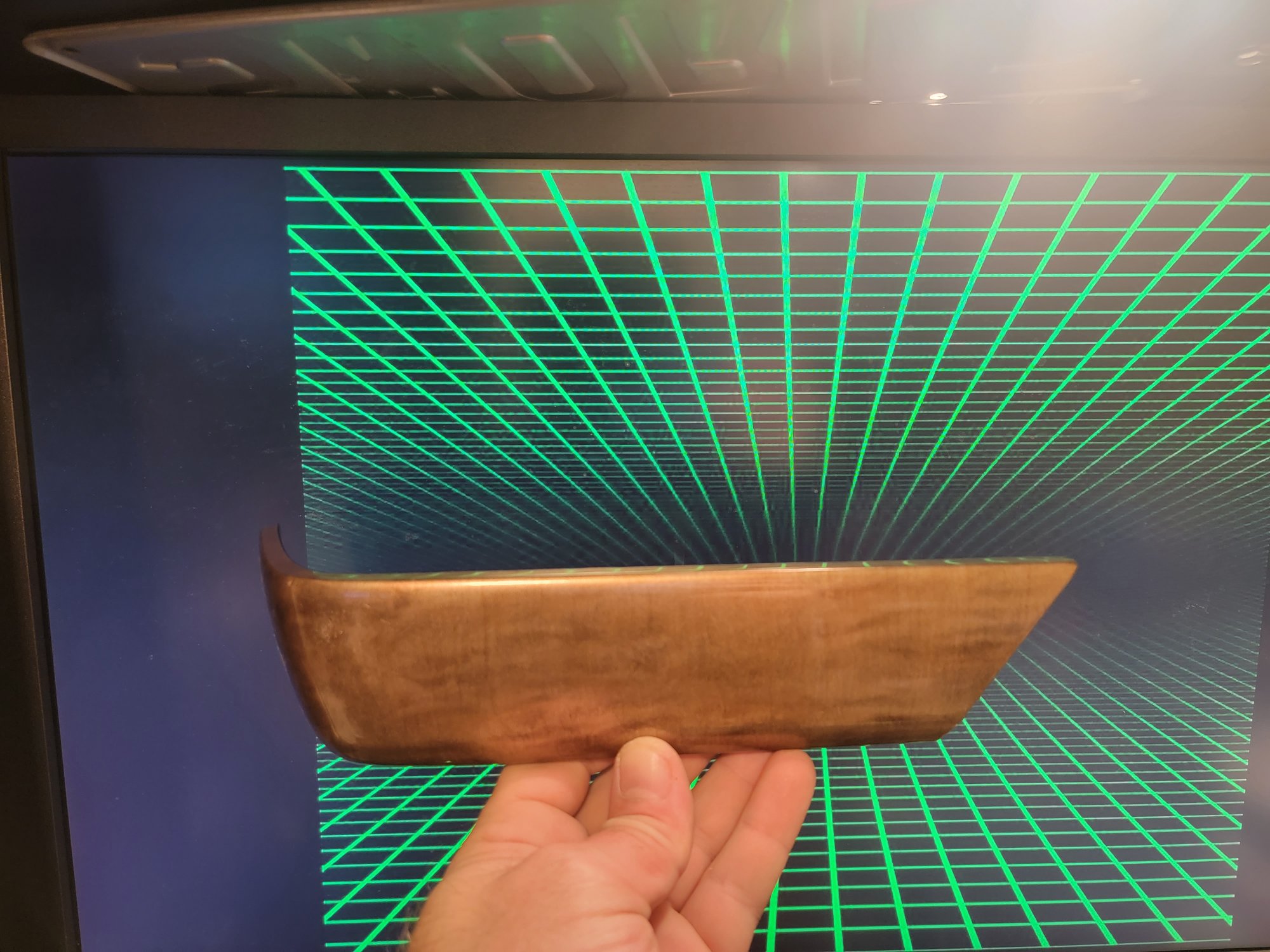

I am thinking you are talking about the accent trim panels? I only have a regular cab, but I recently picked up a crew cab set. The rear trim panels should unsnap if you pull them straight to you as you face them. Here is one of the rear panels so you can see how the clips and orientation of them are.
I was not originally going to go with this colour at all, but I found this full set, for a really good price. Colour is Grand Momiji. I have to say... it kind of is growing on me. Its a bit like marble, but with copper colour instead of the usual greys and white. There were quite a few colours available, but not easily found second hand.
