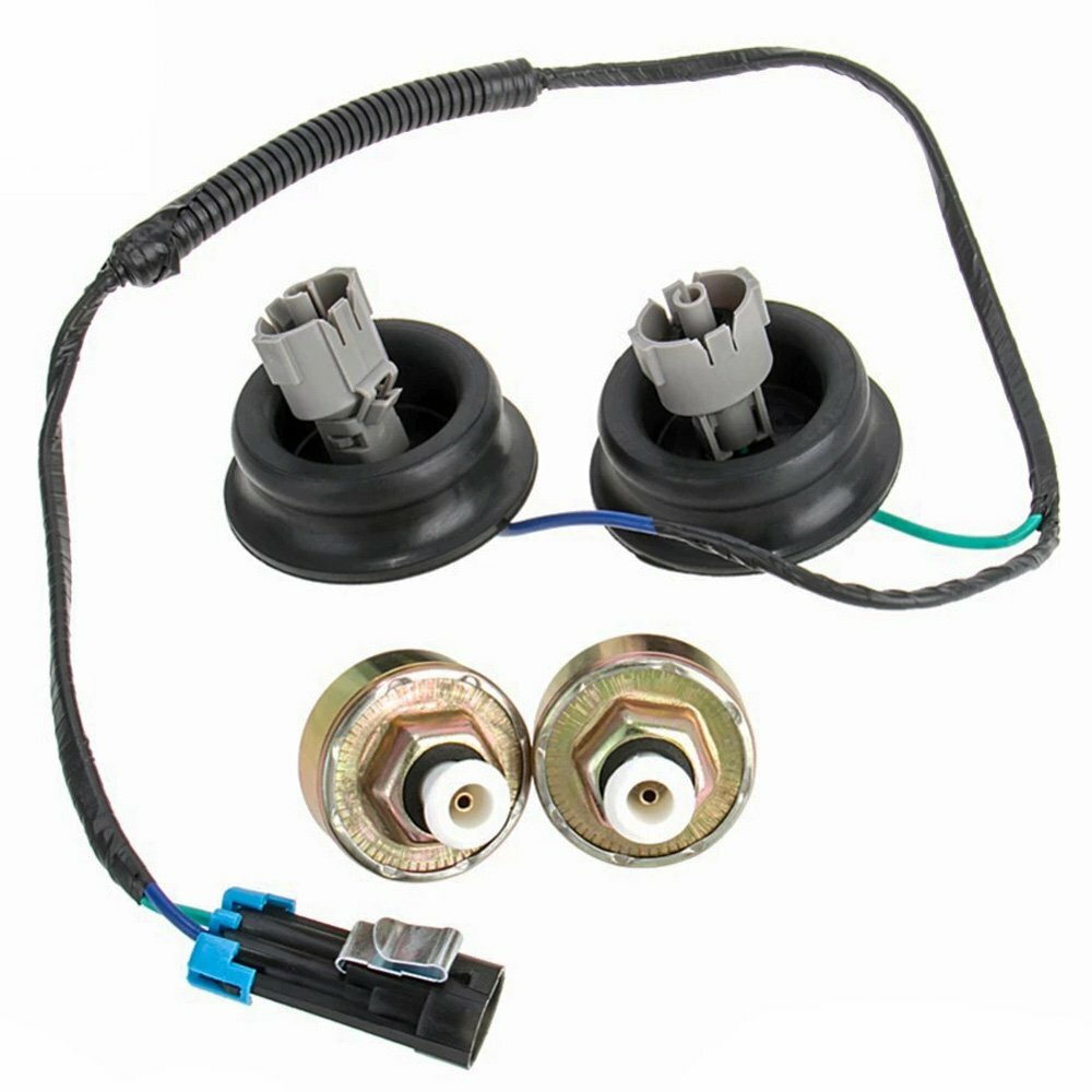

I reluctantly add the following advise:
buy the $20 sensors and harness kit online.
Thread the new sensors into the front of the heads (they thread right in, same hole size)
Disconnect the old sensor harness, and plug the new sensor hardness into the vehicle harness.
Plug the new harness into the new sensors.
Leave the old sensors and harness in place, and don't pull the intake manifold.
It takes about 20 minutes total.
I did this on my 2002 Suburban, a few years ago, and it still runs great with no codes.
See pics:
