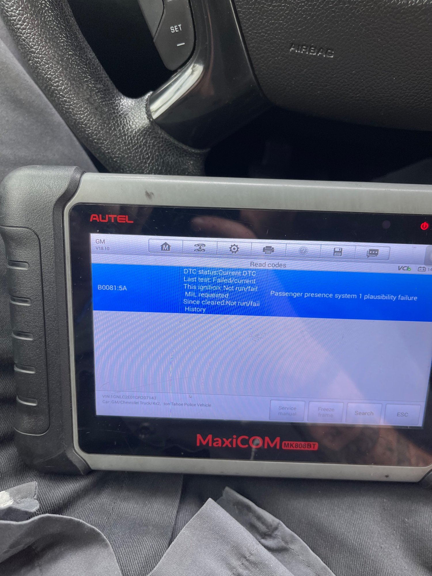

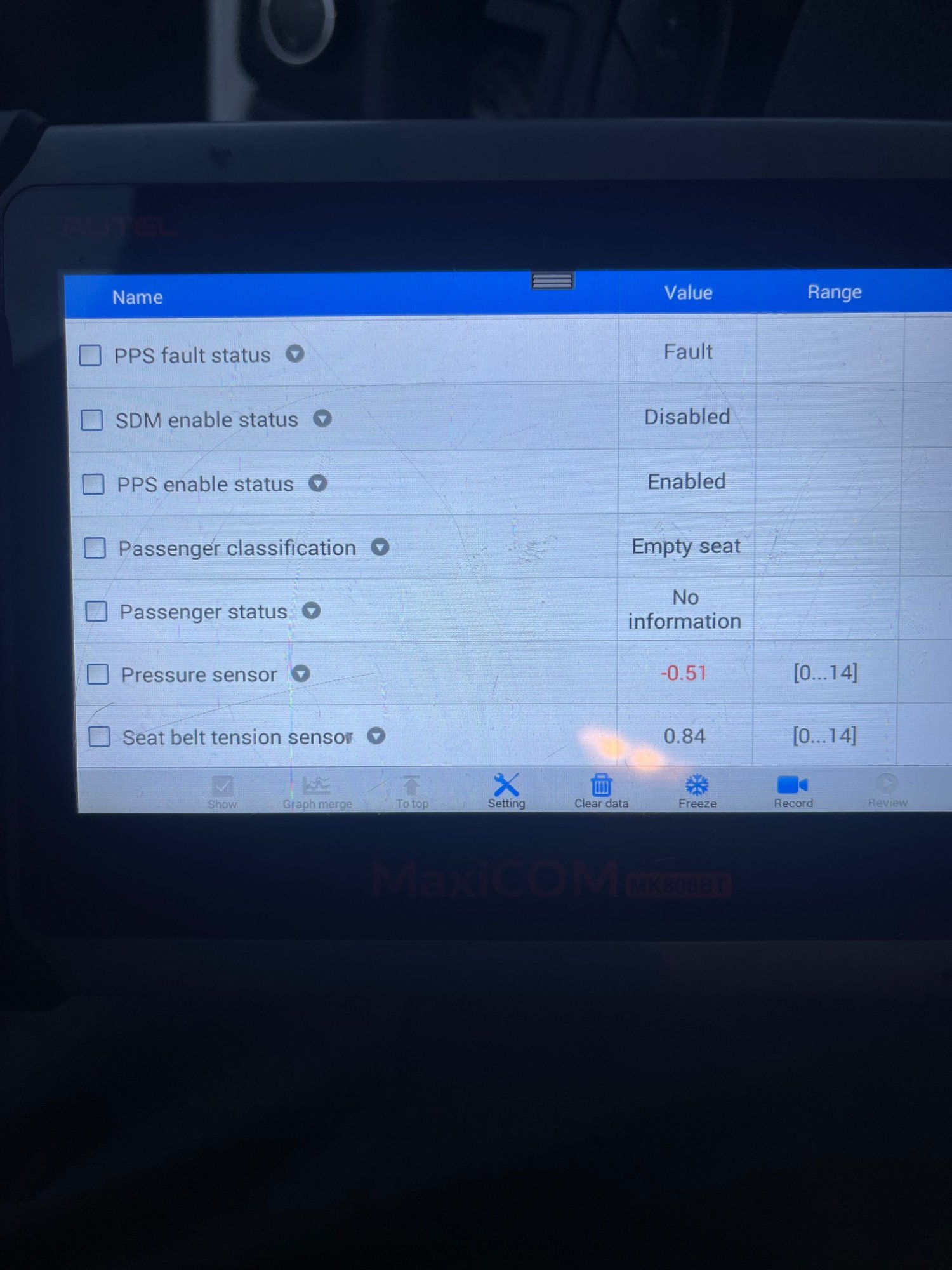

Had a b0081:5A code for passenger presence possibility fault, sensor was reading -1 for the pressure sensor. Got one from the junkyard and plugged it up.  And it now reads .04 still have the code I seen it has to be re-zeroed, but should it have went back to a positive number?
