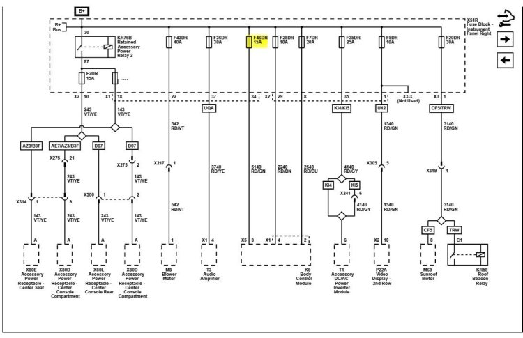

I installed some running lights and tapped into the puddle light wire at door connector. I had power,  but now I don't. Have looked for about 3 hrs with  no luck. If anyone knows what circuit that system is on, I would appreciate the help.
