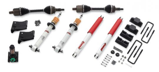

I just purchased a 2019 WT 4x4 and my friend had a 2020 trailboss which he lifted. I was wondering if I can swap out his trailboss supension with my WT? Shocks, upper arms and sway bar. It’s free so I said why not unless it won’t work. Please let me know
The Trail Boss uses the same upper arms and sway bars as your WT.
Here's what's in the factory lift kit.  Thes are the components that make up the Trail Boss/AT4:
2-inch Suspension Lift 4WD 2019-2021 MY: GM Performance Motor
