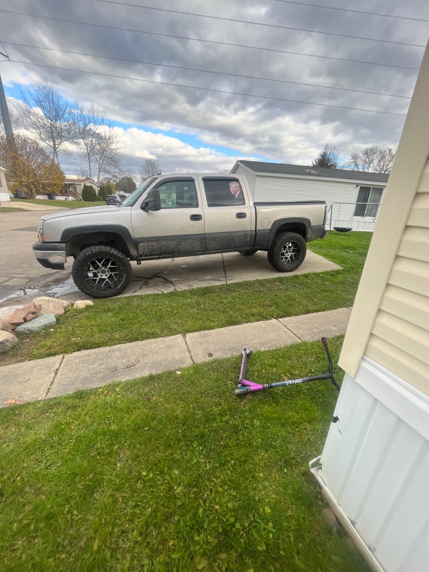

I’m really wanting to switch to klotz or amsoil can anything from klotz be used in a lm7 cold air intake bigger throttle body and long tube headers  redline gear lube thoughts on that if ya got any lol
