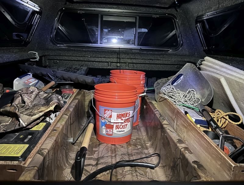

I ordered my new cap before my truck arrived and had it installed a week ago. It came with a battery powered LED light in the rear center. The owner wasn't in the shop the day I ordered the new cap and the son-in-law that works there didn't let me know that ARE now factory installs Rival LED lights. I saw them on the ARE website but prices for the rope lights. Thought they were still dealer installed until I stopped at the shop this week and talked to the owner. He informed about not installing them anymore and only at ARE. I was disappointed.

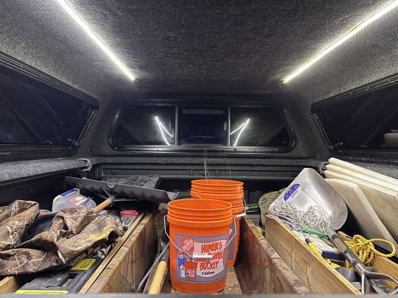

Owner had some 48" LED rope lights that had 3M tape on them and gave me a deal on them. I unrolled them at home and tested on a 12v battery. I wanted to mount them to the carpet like the old cap had. Bought some 48" x 2" Velcro at Michaels craft store. I cut them into 1/2" strips and put the sticky side to the sticky side of the lights. Mounted them in the same location as the old cap had and wired them to the 7 way connector in the bed with a 5A micro fuse holder and a 2 pin connector. Getting the Velcro on the lights was kind of a pain as the lights were rolled up forever. I think it looks ok from wherever anyone from here could see them!
I checked everything during the day and then checked tonight. Surprisingly, the center mounted battery powered LED is pretty bright. One use of the rope lights at night is when it's dark, it's bright enough behind the truck with the rear cap door open to see the crossbow discharge target to shoot at.
Pics in order: 7 way connector with harness, ARE center LED light, right LED rope light, left LED rope light, both LED rope lights, LED rope light switches
