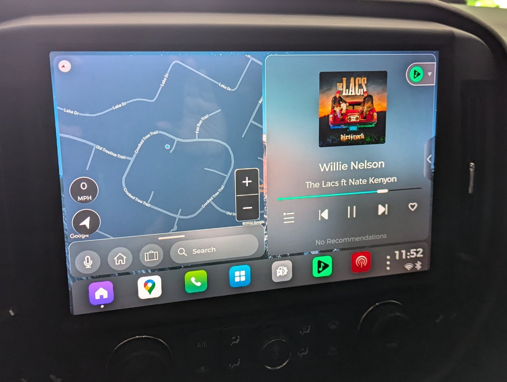

The biggest difference between these Android units and the stock is the User Interface.  The Android can do a lot more than the stock radio but the user interface on the stock is much smoother initially.  The interfaces that came with the radio (this version had 6-7 different options for the interface style) were ok but I finally settled on using Vivid Launcher which I got from the Google Playstore.
Getting the settings right has taken awhile.  The customer service has been pretty dang good.  Given the number of settings and lack of documentation for those settings the customer service needed to be good otherwise I would have sent this thing back in a heartbeat.    I have enjoyed the trial and error and search through the settings doing problem solving.  They did have to send me updates due to an issue with getting the Android Auto working wirelessly but the got it to me within 12 hours of notifying them of the issue.  The time change between FLA and China was the primary delay.

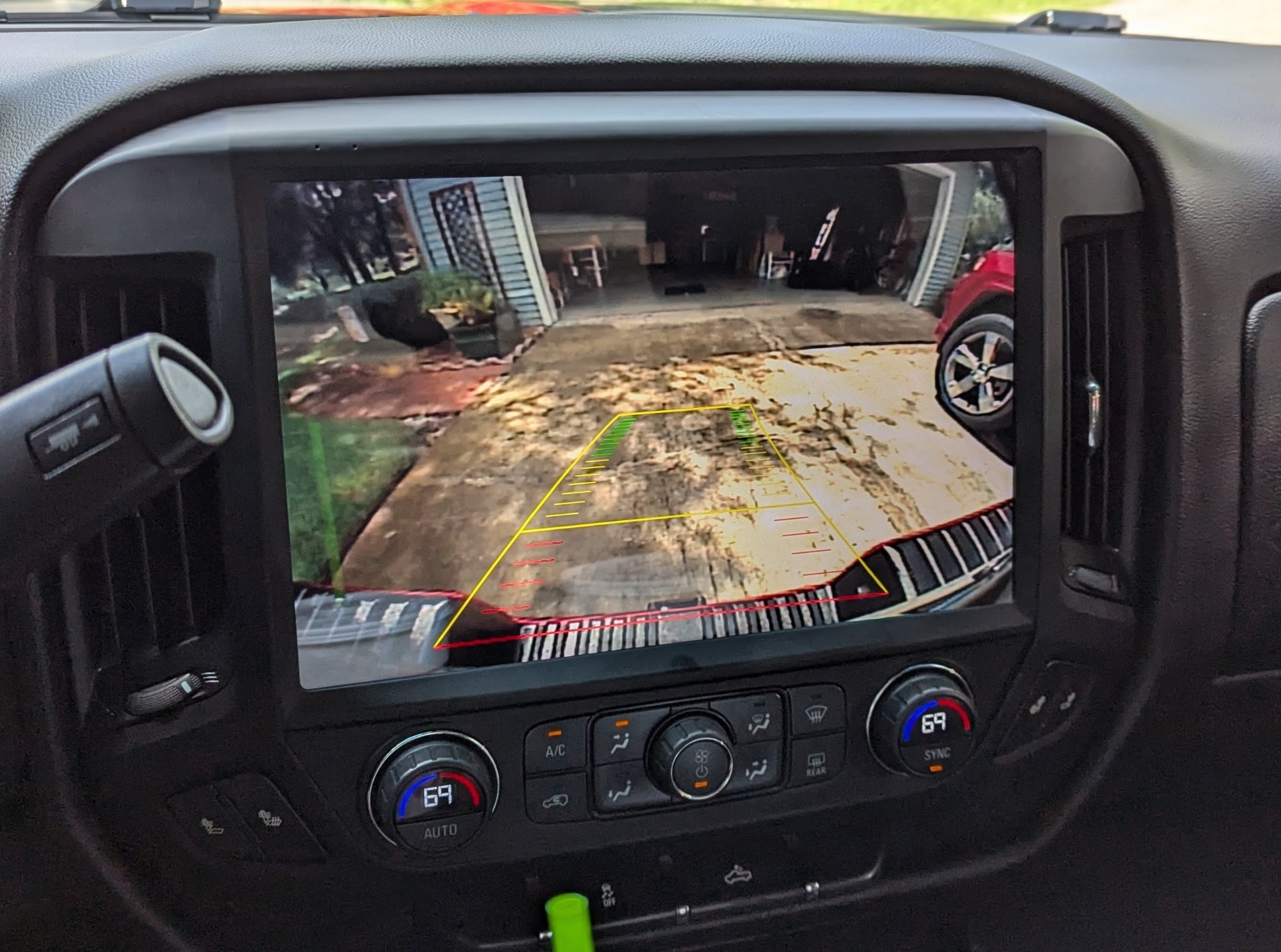

Below are pictures of the radio.  One picture is of the stock back up camera active with the truck in reverse.  I did not use the provided back up camera though the resolution was supposed to be better.  The camera would not fit in the tailgate which was a non-starter for me.  It also would have required running a new wire from the rear to the cab because the wiring integral to the stock camera apparently does not support a higher resolution camera.  I love and am used to the view from the stock camera location.  On my 2005 Suburban I have an aftermarket back up camera on the license plate and hate the angle.  The higher location in the tailgate is better to me.
