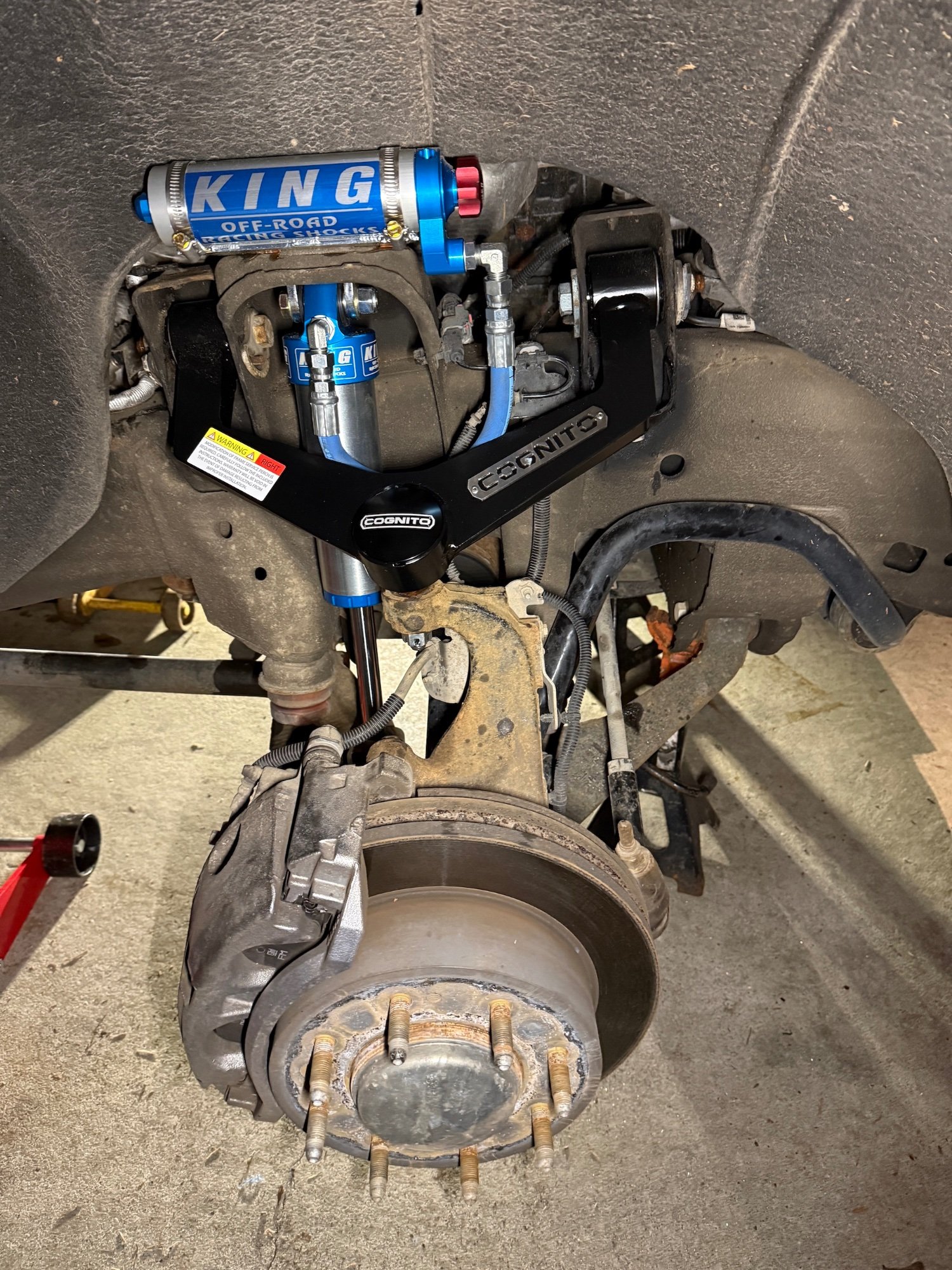

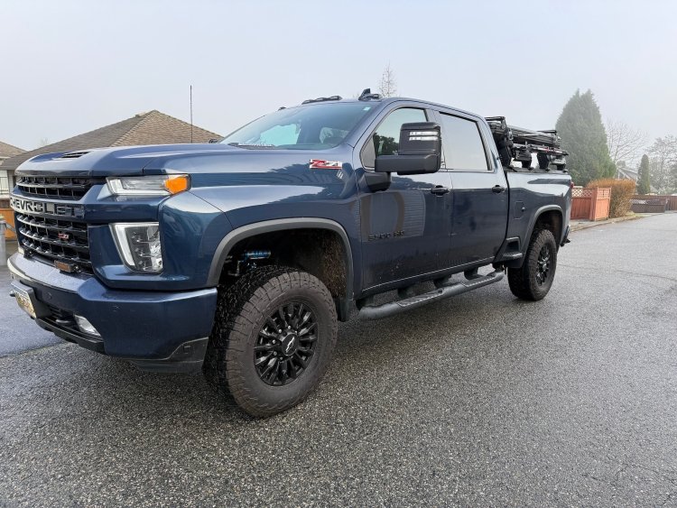

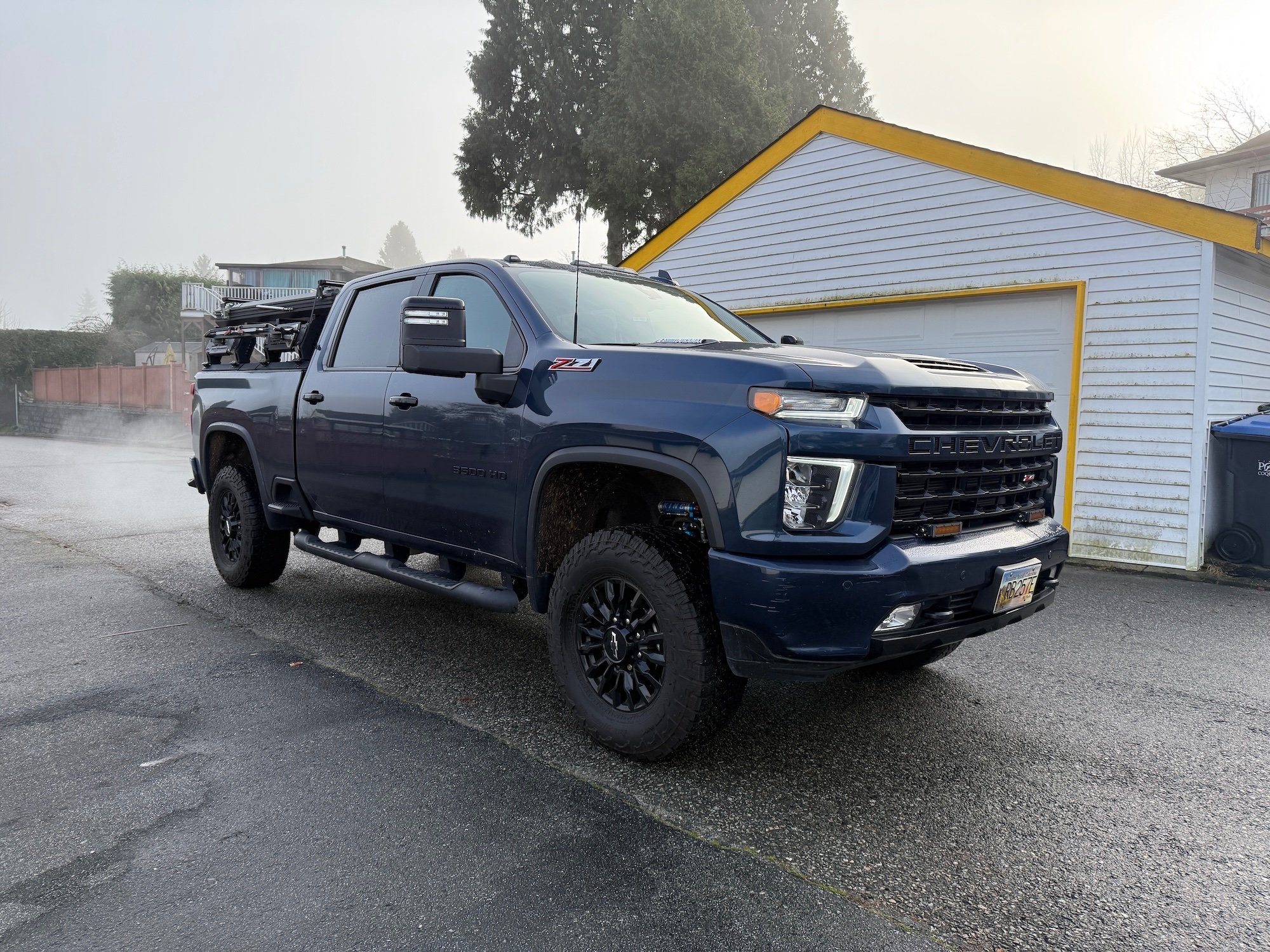

Just bored and thought I’d share my mods from this past Summer, celebrating paying the truck off with installing a bunch of fancy new stuff 😆
Kryptonite Uppers Here with Fox 2.5s, running stock keys turned up. The kryptonite keys even with the bolts all the way out gave me Carolina Squat ( kryptonite said truck is too light with their keys being a gasser plus I have the snowplow prep rated torsion bars.
Full install in my driveway took about a day and a half not killing myself and doing everything proper. The FOX 2.5s were a major pain the ass to get in place especially mounting the reservoir, did I need 2.5s - no, did I just want to be a baller and put them one yes lol .
Added KMC Impact forged wheels 18x8 with 18 mm offset and Toyo Open Country 35x12.5-18 load range F.
I think it came out absolutely killer, very functional setup for what it is, rides the best it ever will with the limitations of the stock suspension.
anyway just sharing in case anyone wanted to do a similar setup. Ask me anything if you like 🙂

Looks nice, did you do anything to the rear apart from the shocks?
I did King Shocks and Cognito UCA's and Cognito rear 1" block.
With the torsion keys, I went with the Suspension Maxx keys and diff drop spacers. It was fun setting the keys up but they give you bunch of different positions to set things up the way you want. I also have a heavy duramax. I raised the front by 1.75" and the rear by 1".
My tires look tiny now at 295/70R18's!

Do you know what your front measurement would be now from the underside of the fender trim to the center of the hubs. Also had you then lifted the front end off the ground and remeasured to figure out what your current droop travel is but also total droop distance as well is now. It would be interesting to see where those numbers land now as the UCA and shock travel etc would play into any increase of total droop travel distance over the stock droop distance which I believe is close to that 28" or maybe just under that.

I will get some new measurements and share. I had them but lost the paper, I will say my droop travel is significant based on how much I need to jack the truck up after this work.
