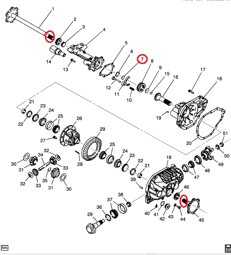

I am having issues with my four wheel drive not engaging. I got under the truck and noticed the right front axle is pulled out from the diff. What holds this in place? From what I can tell it's just a bearing and the seal but I dont know much about the workings of the differential. Is there a clip inside holing the inner axle in place that can fail?

The CV bolts to a stub flange/shaft assembly on both sides.  Those two shafts are held in with circlips.
I'd be worried about internal damage of some sort as those clips aren't too common of a failure.
The clip:
Genuine GM Front Passenger Side Drive Axle Inner Shaft Retaining Ring  12479372 | eBay
Parts exploded view.  I've circled where that retainer clip is and where it goes on each axle shaft:
I’m not sure how the axles are retained on these trucks, but on the ‘88-‘98 trucks, the axles are retained by clips and they simply snap into place and can be popped out with a pry bar. The front differential doesn’t need to be disassembled to remove the stub axles. Maybe try pushing the axle back in and see if it pops into place.
