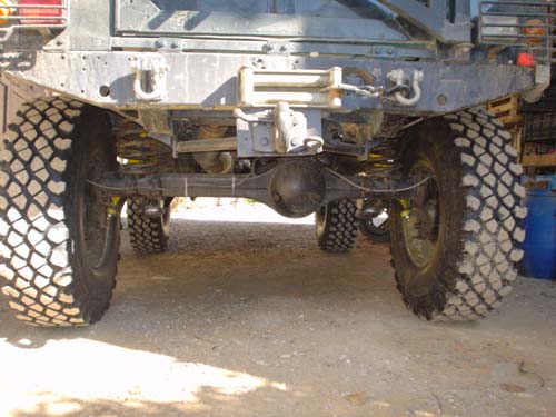

The H1 is a great vehicle but when was the last time anyone saw the price tag on one of those. A portaled independent suspension gives great offroad capabilities but it takes money.
I can't find a picture of the portal design but that's how they get sooo much ground clearance out of the suspension. The axle goes into the portal box located on the end of the a-arms which is very similar to the unimog's axles and I'm pretty sure there is a gear reduction in it also. I remember reading something about the H1's in Petersen's 4-wheel and off road magazine a while back. It's a great way to save the axle from breakage and to gain a good bit of ground clearance.
H1s are portaled ???
Yup, and the diffs are raised up as well. That's why you have a 10' long by 2' wide center console that won't open. :thumbs: Gives mondo ground clearance though. Of course, it's also why you can only fit 4 people in an H1 unless you have the wagon.
And like mudbug660 said, it's the same type system the Unimog has.
Here's what it looks like on a Unimog:
