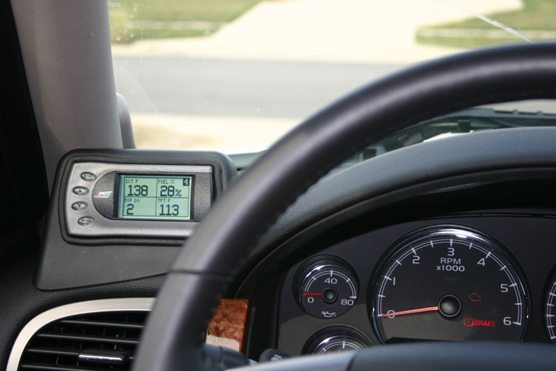

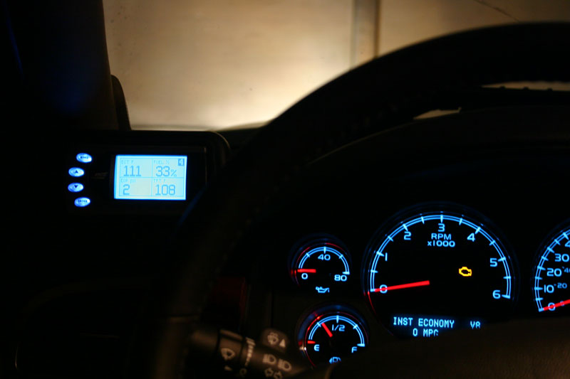

Now you need to change the LCD color to match your gauges.
I use these settings and it matches my factory gauges perfectly:
Red: 45
Green: 80
Blue: 50
and then 20% on the backlight.

Awesome! Thanks... Is the backlight 20% or the Contrast 20%?
I left the contrast alone. The brightness is adjustable while the different gauges are visible by pressing the up and down buttons in intervals of 10%.
Gotcha! What is your Contrast set at? I've screwed with mine so much I can't remember what the default setting is!
Contrast is set at 35 I believe.
