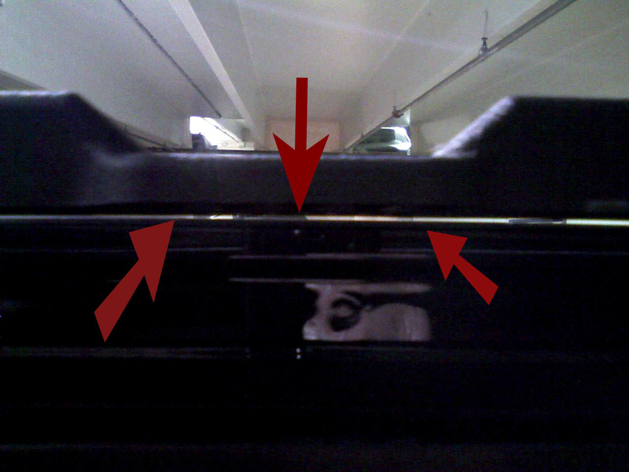

Okay, I checked the rivets holding the spring steel down that pushes up the deflector. They appear to be be tight. However after careful inspection it looks like the deflector raises about an 8th too high so the bottom of it in the middle is slightly over the roof of the cab so some air can actually get below it.
See the picture. The red arrows are pointing to the perceived gap.
yep, those rivets may be tight, but not holding it down correctly, make an appointment with the dealership and they will rip out the old deflector and probably replace it with a new one with new rivets and probably put some double sided tape (for good measure), unless you want to do that............
