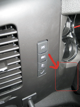

hey, Im one click away from getin this nice mod but am worried about one thing.. will it fit?
If you remeber "daddy" made a topic about the DIC upgrade, going with the information he provided it should work.
The only thing diffrent from his cluster and mine is he has 6 guages and i have the basic 4. the bottom pc of that panel looks longer on the 4 cluster then it does on the 6. is this true??
here is a pic of the 6 guage cluter to get a better idea of what im talking about..
thanks for the help.
todouble,
All you have to do is pop that plastic cover open and see if the plug is there for the DIC if it is it should work.
Exactly. Sveral guys have added this to the WT's. I think you'll be fine but definitely check for the wire first.

QUESTION ANSWERED, thanks guys it was there.

I did this mod on my truck. Very easy. Bought GM part, has new cover and DIC switches, plug in is right there when you remove your cover. Worth the 99.00.
Chief3
Before you order online, ask your local GM dealer if they will meet gmpartsdirect prices. The local dealership here will honor their prices and can have the part a lot quicker. Doesn't hurt to ask.
