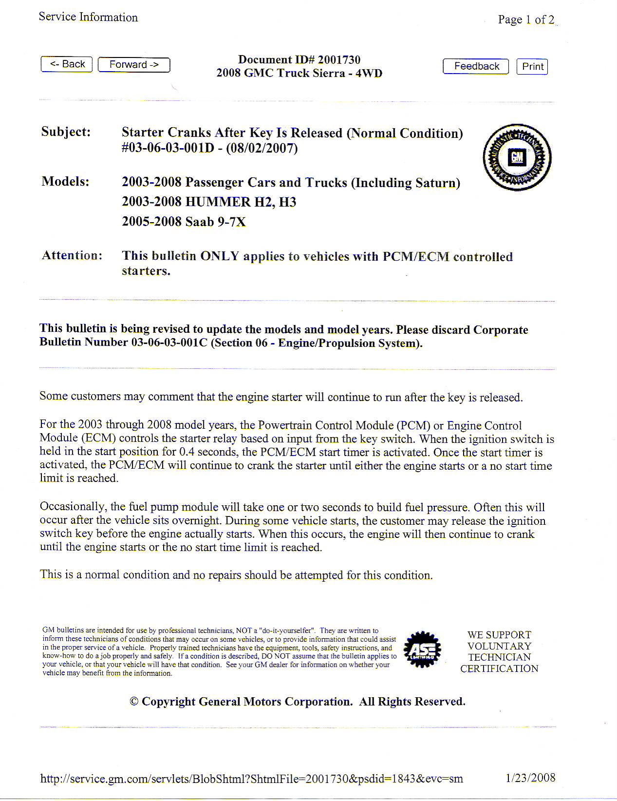

OK...I hope this works. Here is the Bulletin on this issue. At least this is what they tell me.
OK it didn't come out very well. Sorry....
