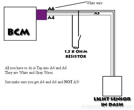

It's real easy to do. You just need a 1.5 K ohm resistor and a couple of wire taps. Tap 2 wires across your BCM that go to your Auto Light sensor on your dash and voila!.
Let me know if you want a more thorough answer. It's like a 20 min job. Piece of cake. i even wired in a switch so I can return to full auto if I want.
-Evan
Alright here yah go:
FOR '99-'02 TRUCKS ONLY w/o AUTO CLIMATE CONTROLS
Basically you will need a pair of wire cutters and a 1.5K ohm 1/2 watt resistor that you can get at Radio Shack. Electrical tape and possibly some wire nuts will work to wire in the resistor. You can solder the wires if you wish.
You may want to remove the neg. battery cable to assure you don't do any unwanted damage to the electrical system. This is not necessary, but a good precaution to take.
First locate the Body Control Module (BCM) which is under the dash, below the steering column. Laying on the floor, this should be visible without removing any dash panels. You should find a purple connector (C3). Unplug it.
Locate the white and gray wires (A4 and A6). I don't remember if white is A4 and gray is A6 or vice versa. It doesn't matter anyway.
Clip these two wires that are coming off this plug (C3). Leave a few inches to work with. Tape up or place wire nuts over the other end of these wires that go up under the dash(they go to the light sensor). You have now removed the light sensor from the electrical system and is now just a dash ornament.
Connect the gray wire from the plug (C3) to one end of the resistor and the white wire to the other end. Make sure you tape up all wires to prevent a short. You should now have a gray wire coming from C3, going to one lead of the resistor and the white wire from C3 to the other resistor lead. Plug in C3 to the BCM and replace the neg. battery cable if you removed it. Start the truck and make sure the lights are off. Throw a dark towel or something over the light sensor on the dash and verify the lights stay off. Try your light switch that has probably never been used and that's it!"

Why don't you just wire it like my diagram is and that way you don't have to replace the switch. You just have a little micro switch that does the extra step that switches from Auto to Regular Control?
A micro switch and a 1.5 K ohm resistor should only set you back about $5 whereas a whole new GM Switch could be $50 or so??? I mounted my Micro switch down next to the OBD2 Reader so if I want it in Auto Mode I reach down and take the resistor out of the loop and if I want manual control I just flick the switch in the other direction.

I have a few questions before I attempt this. You said to clip the wires to the sensor? Actually cut them and add the resistor into the harness, and the wires for the sensor go away, or just tap into the wires? Also if you used a switch how did you wire that in? Didnt see it on the diagram that you have.
Thanks!
Slayer,
Just use 2 "hop clips" I'm not even sure what they're called but they snap on to the existing wire so that you don't have to cut the old wires and leave everything the way it's suppose to be.
The switch just goes inline with the resistor. In the diagram the break in the line to the resistor indicates a a switch. If I get some time on Thursday i'll take some pics of it for you.
So to quickly answer your question you don't need to cut any wires just "tap" into them. That way you can still use the auto sensor if you wish.
Thanks!
Slayer,
