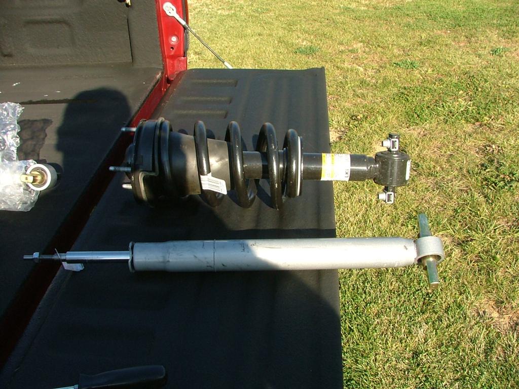

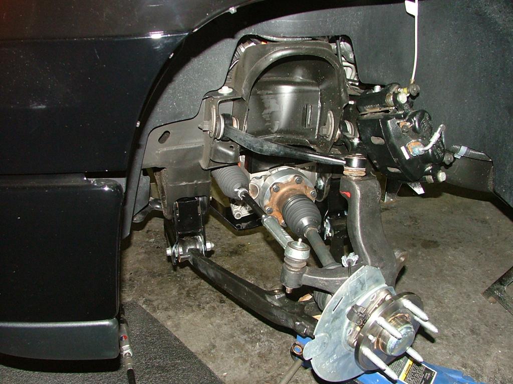

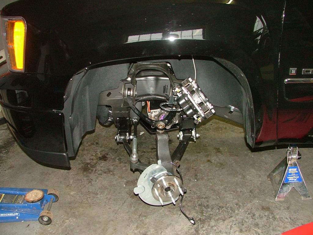

Here are before and after pics. Sorry for the poor quality, more to come when the tires get mounted

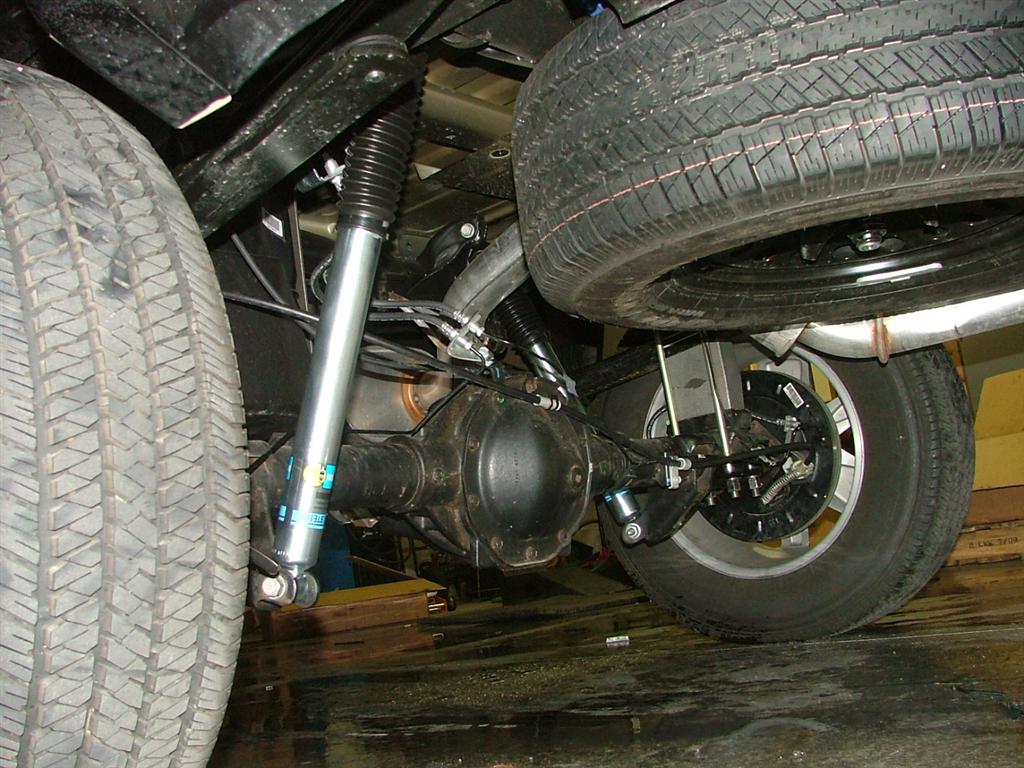

post-54219-1226264042_thumb.jpgRear lift is accomplished with a block and new longer U-Bolts
There is a bunch of stuff that needs to get relocated in the rear to make this lift possible, definately not a two hour job like I once thought!
I like the front end setup. Not a fan of big block lieft for the rear. I'd prefer new springs.

I agree with you, but when I read that I had to drop the fuel tank to replace the springs, the blocks got the nod. If I get any axle wrap, then I'll get new springs!
