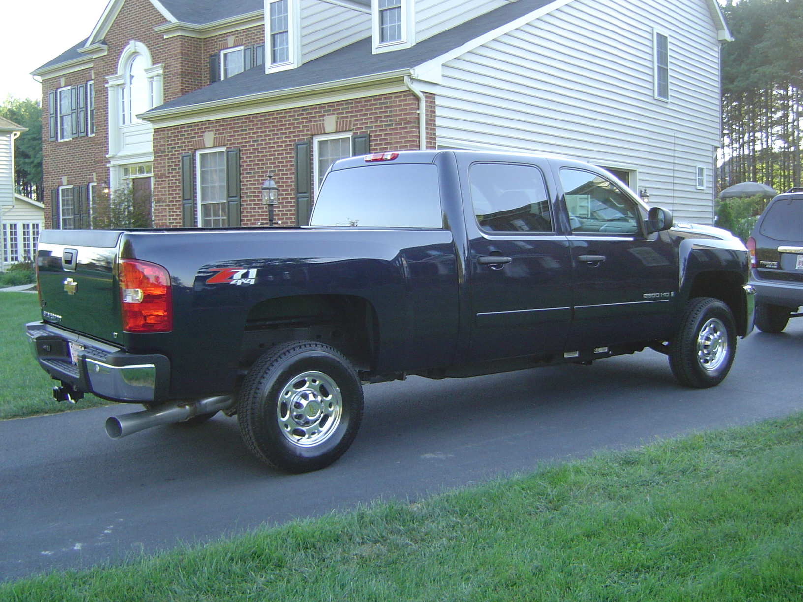

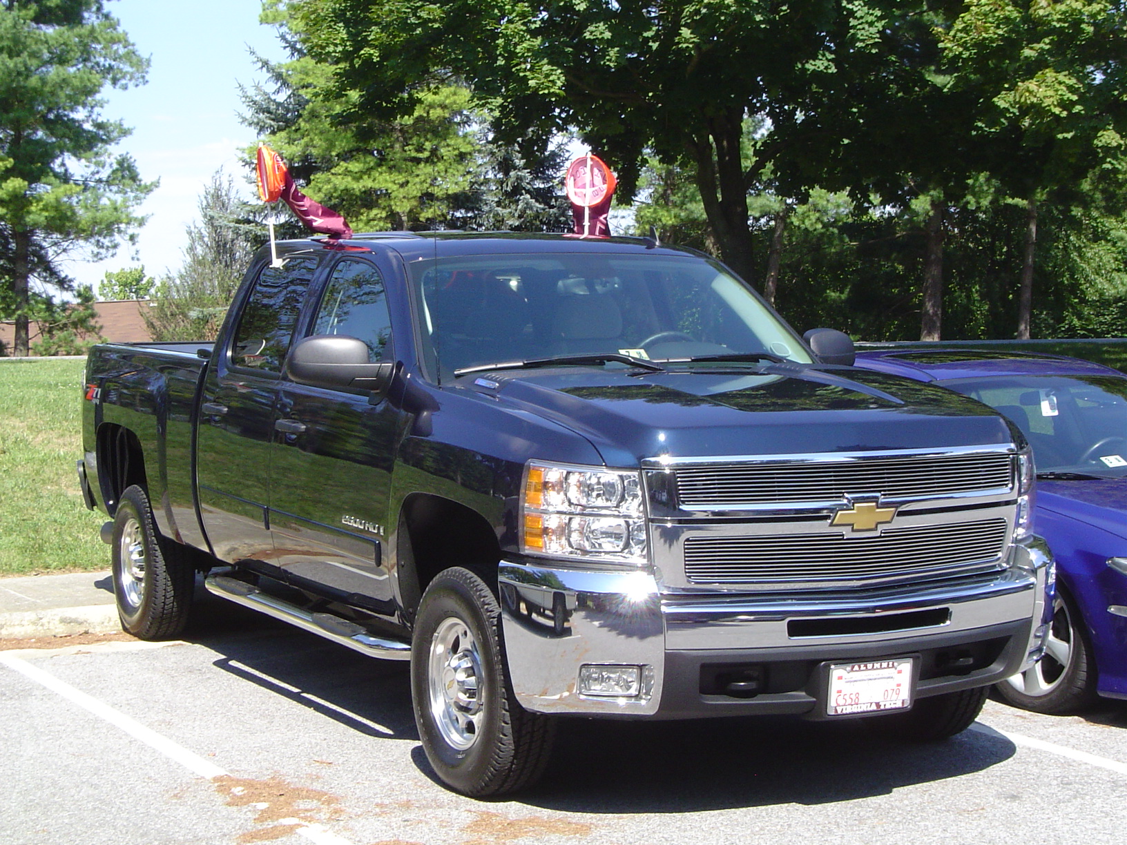

If you are going to keep the truck for a long time and want a tire with longevity and good traction, then I would suggest the Michelin LTX/MS in a 265/75/16. This tire is quiet, has excellent rolling resistance, great taction, and will last 60-75K miles. An excellent tire and worth every penny!
Anything over a 265 will probably rub. I have 265/75/16's and get a slight rub at full lock with a little compression. No rub on level ground. I purchased some Mastercraft Courser C/T's. I think they were around $160 ea otd. I only have about 10k on them but so far so good. No sign of heavy wear at this point. 265's help fill up the wheel well a little bit.
