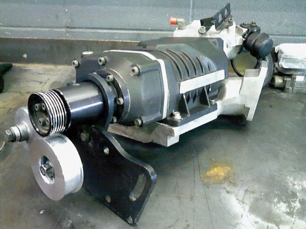

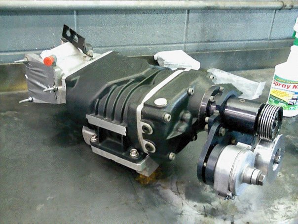

So work was really slow yesterday so i spent the day inspecting and preping my whipple, going to be pricing out some goodies, got a line on a Bosch 220 litre per hour in tank pump, plus bosch green top 42lb/hr injectors, all i can seem to find is a 180f thermostat, would like a 175 or 170, but i may be limited, going to price some new lifters a cam and roller rockers, whoa boy... i may need to sell my 51 chevy cause i REALLY want this to happen (:
heres a couple pics of the charger all cleaned and preped,
