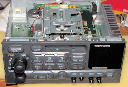

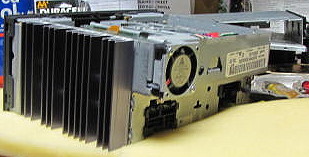

I have been recently experiencing the Radio Sound going out intermittently and then coming back on sometime later.
Someone mentioned there may be some cold solder joints that may cause this. If someone knows, please let me know where the ones that causes this condition.
Pics are attached and appreciate you assistance.

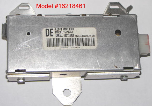

In addition to my above post, I finally found the Amplifier that may be helpful to others tracking down the same Radio problems... which could be the culprit of the Sound going out.
It is located just to the Right of the Steering Wheel under the Dash. Here is some pictures and Part # of the Amplifier:
After taking out the Amplifier, I found a Speaker Relay attached to its body,
Part# 12065125 or Now the 13502676 or Delco D1703A, which could also be the cause of this problem.

Did we ever find out the specs on the factory amp? I looked everywhere but could not find any info on it.
