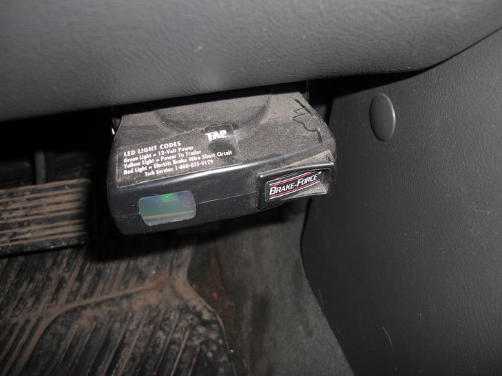

I snapped a pic of it. It all plugs in there are no wire splices or anything , thats why i thought maybe it really was factory installed???post-58540-1231657525_thumb.jpg

Not factory installed. This was not an option till 07.
2 things:
My controller stays on for about 5 min after the key is turned off. Are you sure yours is on all the time?
Yours may not be hooked up to the correct power supply. These hook up with a harness to the panel under the dash above the brake pedal. See if the wires from the controller go into this box. There is a plug in area for the controller should be no wire splicing needed.
As long as the controller works that light being on will not effect the batteries life.
Yeah, definitely not a factory brake controller.
A buddy of mine has a 'uhual' brand in his truck, and I'm sure the light is on all the time. He hasn't had any issues with battery drain in 2 years.
Might be a good time to consider an upgrade to a Prodigy. ;)
