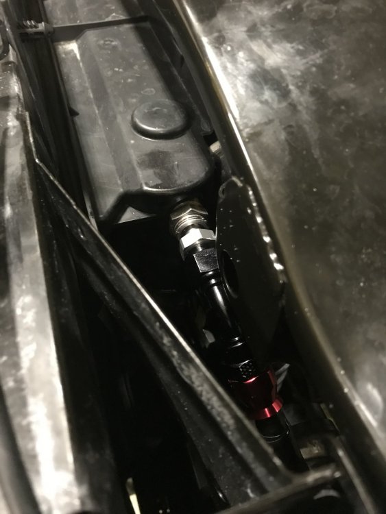

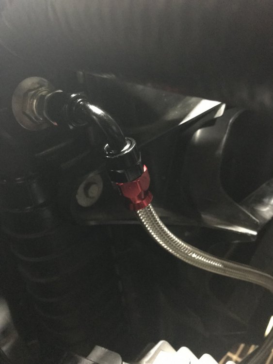

Can you post a link to the fitting? I was only able to find one that converted to a standard hose barb, not an -AN male flare. The lines and filter simply replaced the hardline jumper between the radiator and condenser. My trans fluid flows through the radiator, then the filter and then the condenser. -
