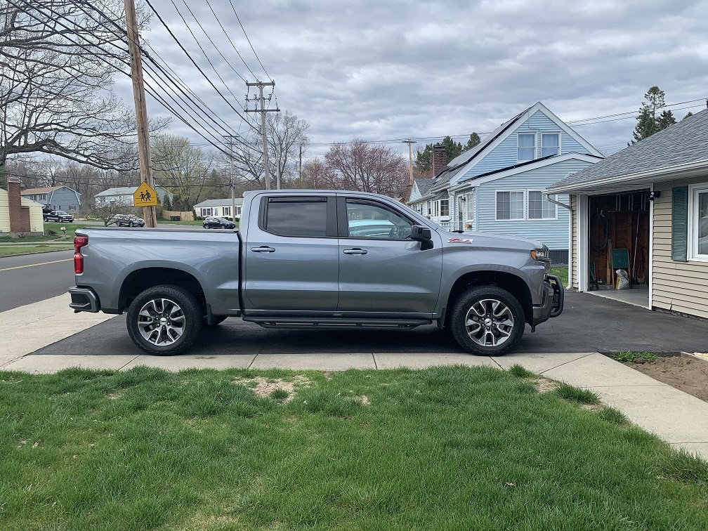

Final got some new tires. Have a bilstein 6112 up front set a 2 inch. With 1.25 block in rear from 2009 silverado. Went with 275/65/20 Bridgstone Revo 3. 34.1 Tall. Was looking at a lot of different tires. They got good reviews and where one of the most lightest LT tires out there 52 lbs. Was considering the Nitto Terra Grappler this size in p-metric was 47 lbs. But Revo reviews sold me. Was still concerned about contact on the mud flap up front. I removed it before I got the tires to see if I could gain some more clearance. There was a 1/8 thick metal tab in the back where contact would be close. I used a 8 inch c-clamp to bend it back as far as it would go. Then used a sheet metal screw to pull the liner back into it. Gained a good 1/2. I think the metal block can be removed with three bolts. To bend the tab back off the truck. But the clamp worked great. Tires ride great. Very quite. Fills the wheel wells just right. Speedo still reading correct.

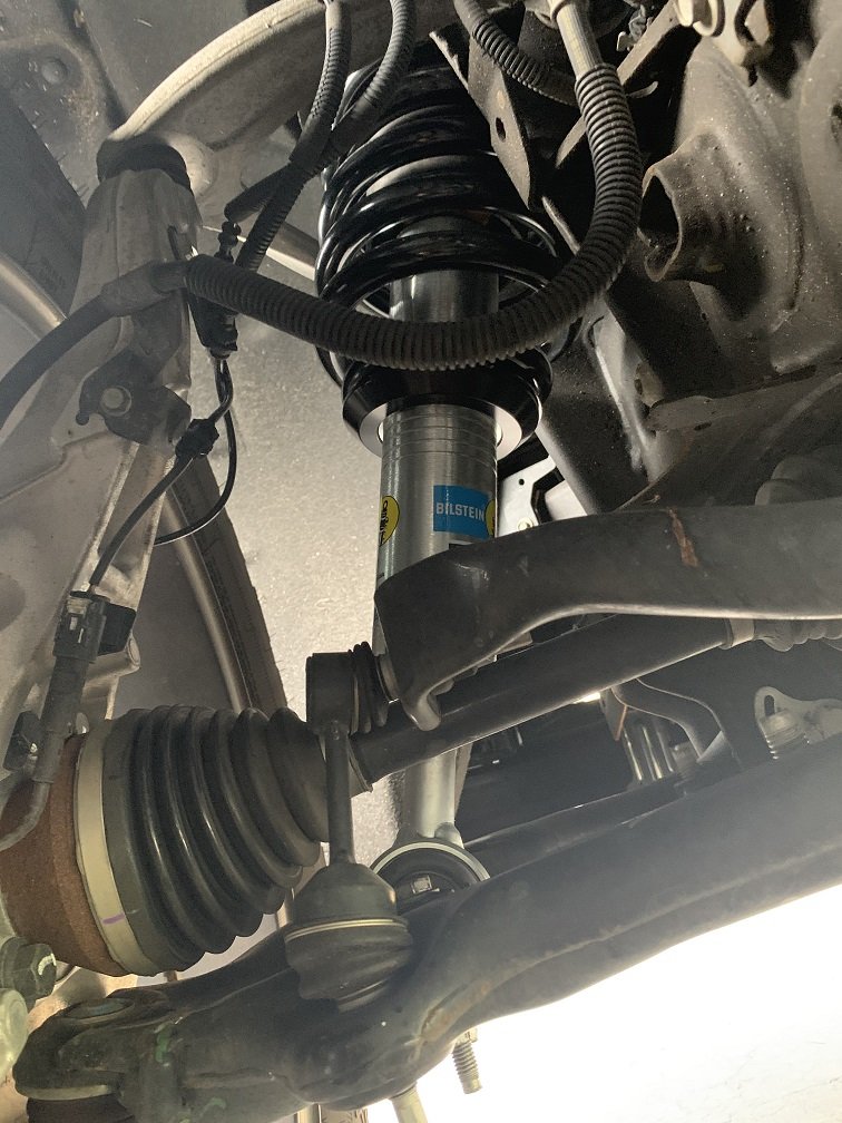

Yes those are the ones. You will love the ride quality Better then stock plus the lift. Get alignment done after. This was the day I installed. Did further test. It did hit when I jacked up the truck let tire hang.

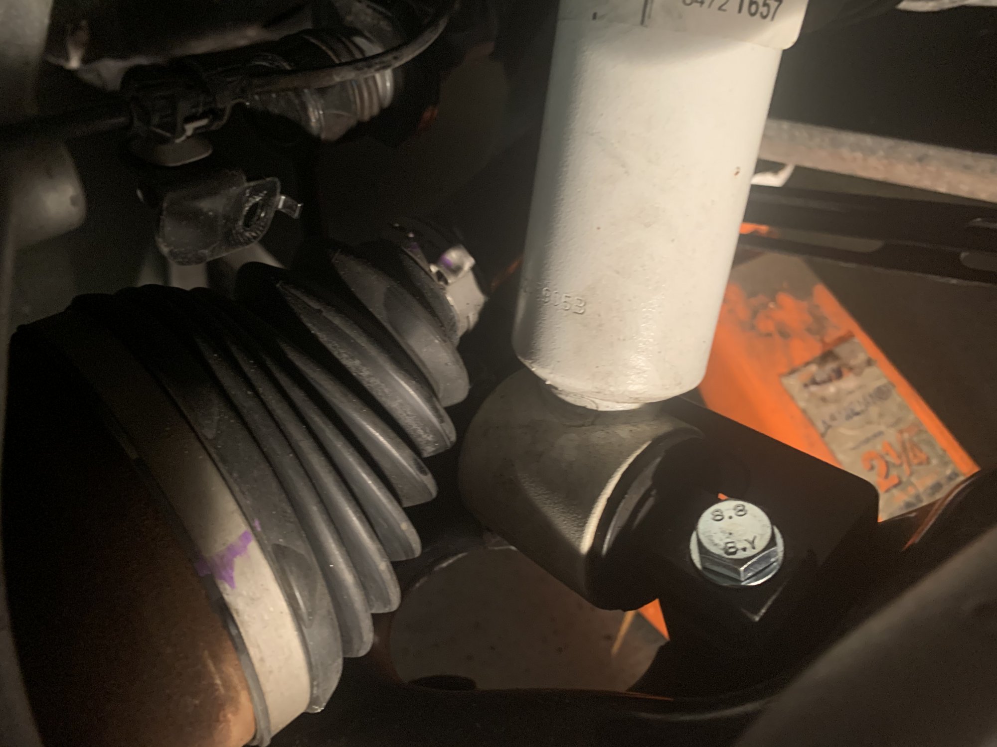

Yes don’t install them. The bolts come to close to the axle boots touching at full droop and turning . I removed them like two weeks after I installed them. Went with Rough County fully assembled 2 inch struts. I posted somewhere about it. Like 320 for the pair. Ride is better then stock. They have settled to about 1 5/8 of lift. Perfect with or without the 1 inch rear block. Don’t use the lower space.
Yes don't install them the bolts come to close to the axle boots. Hit at full droop and turning. I removed them two weeks after and use Rough Country 2 inch leveling strut. Ride is way better the stock. You will love them. Have Beilstein in the rear. Will eventually put them in front. They weren't out yet when I did it. Settled at about 1 5/8 of lift. Perfect. Don't install them . Don't take the chance. P.S Moto Fab Fine for 2 wheel drive

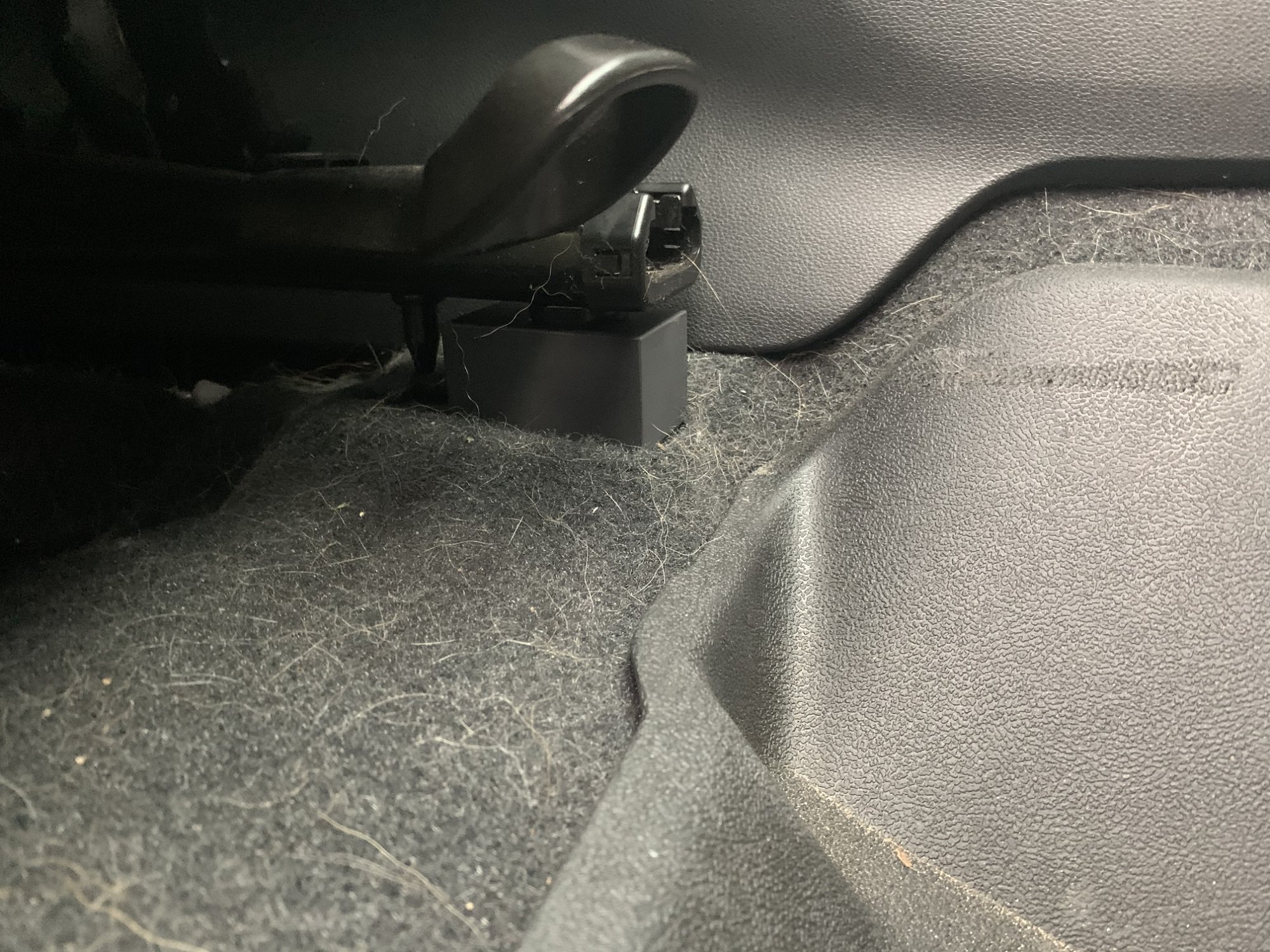

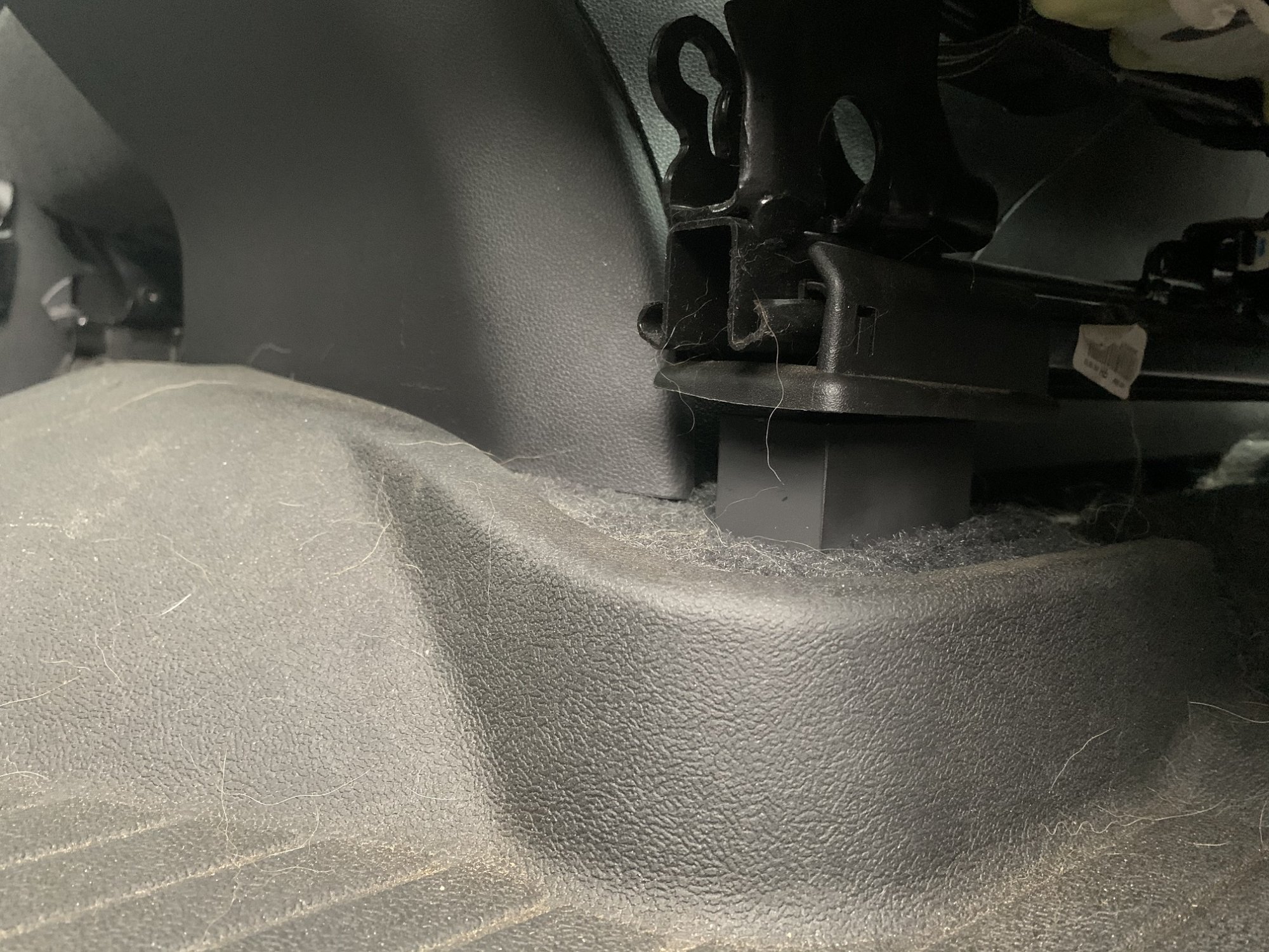

Made my own seat raisers for the passenger seat for my 2020 RST. Used 1.25 thick alum blocks. Spray painted black. Bought m10 * 65mm long . Grade 12.9 socket cap bolts at local nut and bolts store. Work in machine shop so materials were free. Seat was so low. Not that I sit there much. Saved a bunch of money. Like switching to Geico. PS sorry about all the dog hair. -
