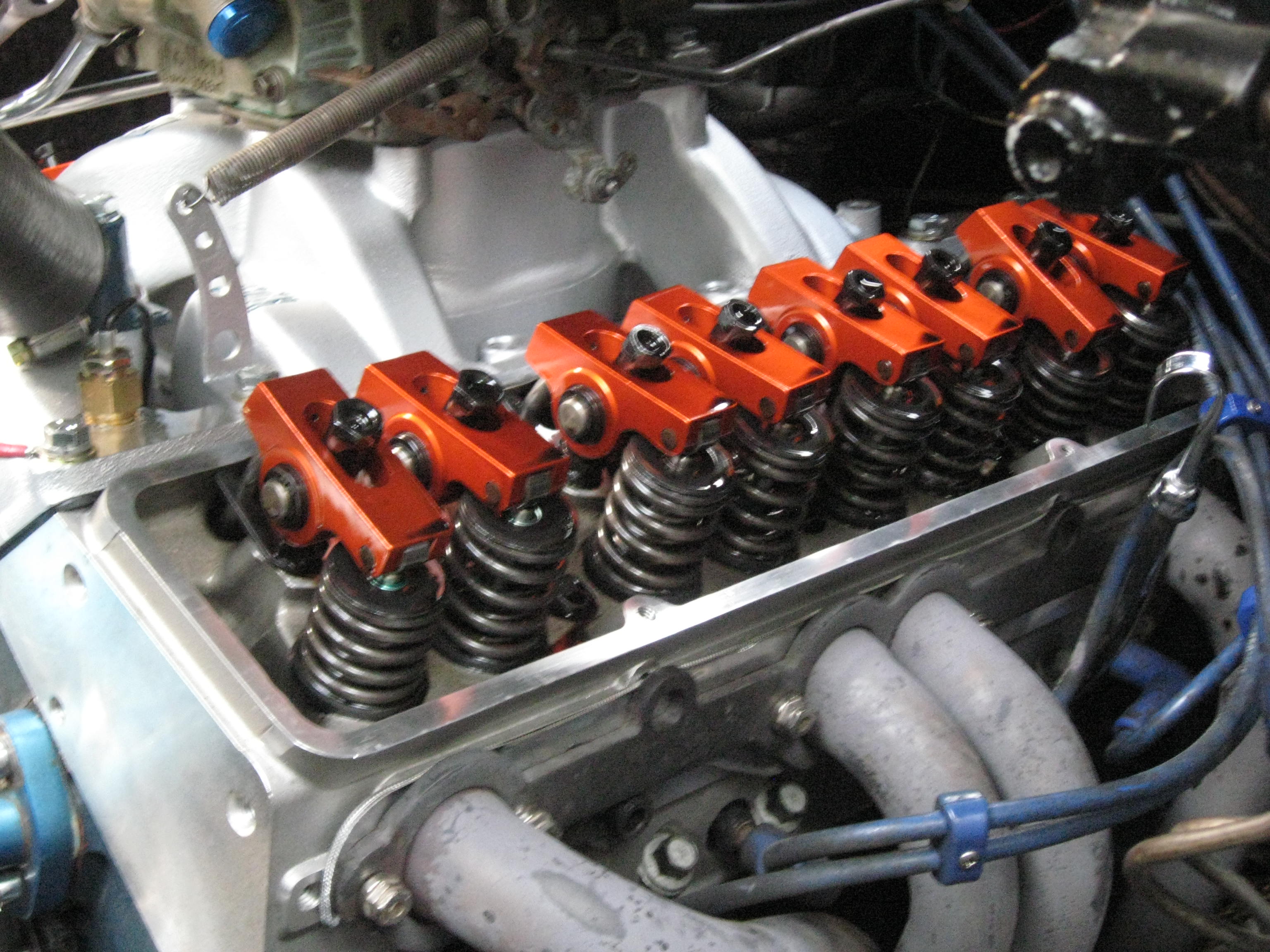

As far as the rocker arm question goes. By upgrading to roller tipped or full roller (depending on budget) you are reducing friction thus freeing up horsepower. Theoretically you would be gaining mileage. There is a nice article about roller rockers I found on the Car Crap web site. On average full roller rockers free up 8-10HP. Car Crap found they got 11HP and 6FtLb's of torque. Here is the link: http://www.carcraft.com/techarticles/116_0101_roller_rocker_ratio_test/index.html
Some guys do the split ratio rockers to get some more performance. It is actually a real popular thing to do. This is where you would put 1.5's on the intake and 1.6's on the exhaust. Here is Summit's explanation: "The lobe lift of the camshaft is increased by the ratio of the rocker arm to produce the final amount of valve lift. A cam with a .320” lobe lift using a 1.5 ratio rocker arm will have a .480” valve lift (.320” x 1.50 = .480”). If you install 1.6 ratio rocker arms, final lift will increase to .512” (.320” x 1.60 = .512”). The engine will respond as if a slightly larger lift cam had been installed. Increasing the rocker arm ratio is an easy way to improve the performance of an existing cam."
The prices of SBC valve train parts have been coming down in the last 10 years. I checked with Summit and you can get a set of Proform 1.5 ratio roller tipped rockers for $75 and a set of full roller's for $186. I personally run Harland Sharp's full rollers and they are I think around $220. If it was me I would get a set of full roller 1.5 ratio rockers.
