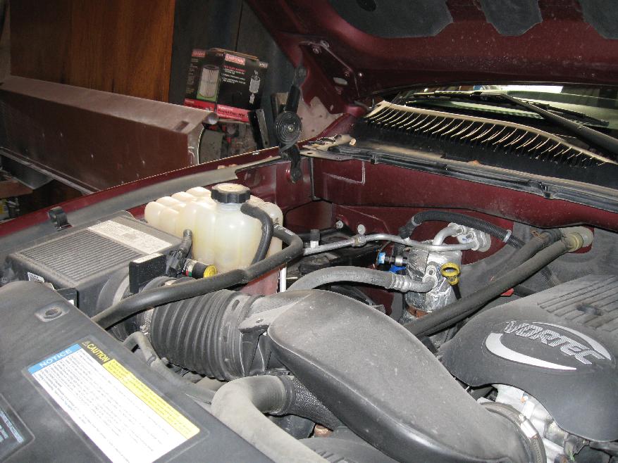

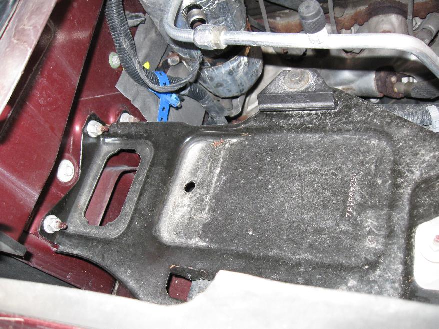

Where did you put the tray on your 01? Upper passenger side corner? I wanted to do an extra battery, but that area where the second battery is to go is being occupied by my big Western module. Though about do an inclosed battery box or something and mounting it in the bed near tool box, then running cables to first battery. But then that would mean drilling a larger hole thorugh bed to feed cables through. There really isn't any other place for that Western module and it is pretty big! Compared to older plows (last generation and beyond).
the spare tray on the 01 went on the passebger side rear near the fire wall ,you replaced the brace with the tray .
Thats what I thought. Thats where my Western plow module is, and it is quite large.
