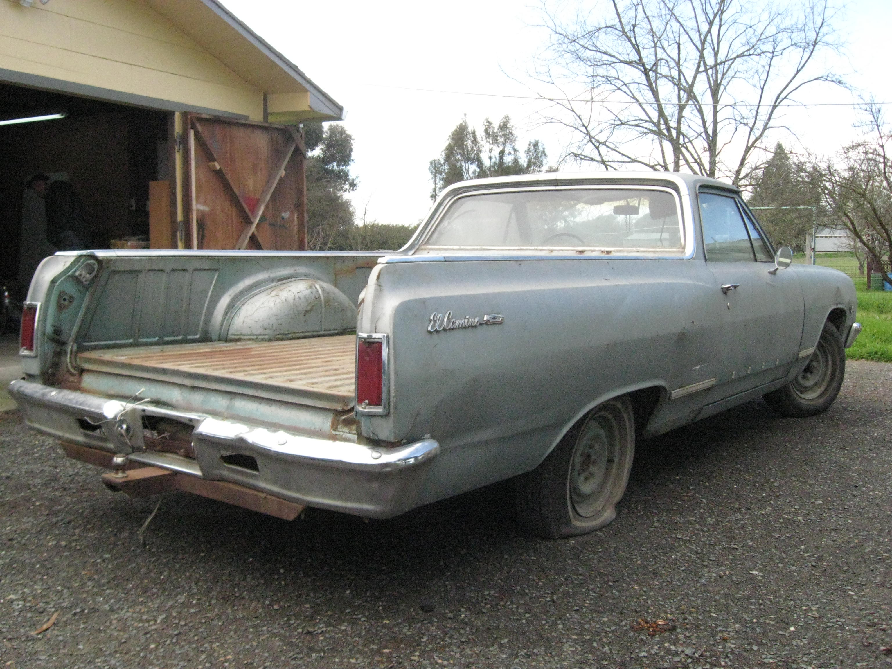

This is a picture of the cars good side. This was after we towed it home. It looks quite a bit different now. But I don't have any current external pictures.
Heres another picture. I was wrong on the last caption. These pictures are of the bad side.
