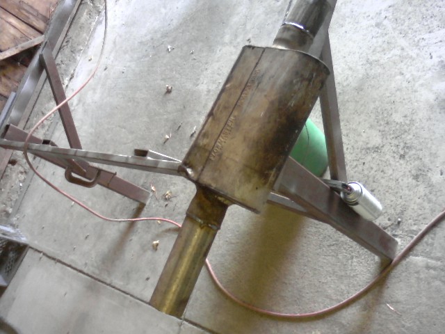

With my truck I installed a original 40 series 2 chamber SI/SO. I just cut out the old muffler and welded in this new one with 9" of pipe to fill up the room from the old one. So the truck still has the stock exhaust pipes. I have a decibel reader and took before and afters from in the cab and at the rear.
At idle stock I measured the decibles to be 60 at the rear. I'm now at 75. In the truck I measured the noise level at 65MPH. It was 60db with the windows up, HVAC off and radio off. It is now at 70. There isn't too much droning resonance nor is it obnoxiously loud from in the cab.

I got to thinking. I didn't mention that this was in my 2000 1500. Now on my 70, I have 2 40 series with 3" piping. Now it is insanly loud! Especially since the pipes exet before the rear wheels.
I meant to put this pic in.
